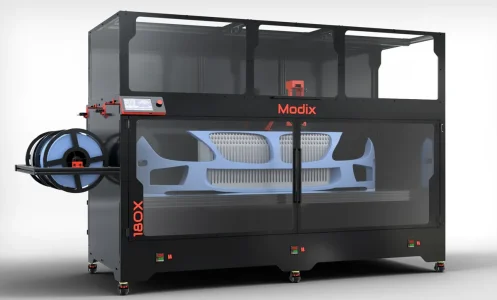

Here is one if you want to make BIG toyz... but they have a bad reputation. Keeping a bed leveled that size is trouble...

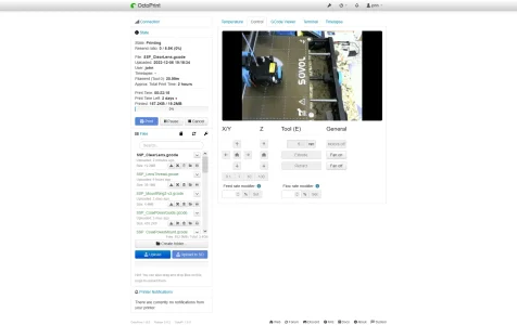

I ran off WiFi into a Raspberry Pi running OctoPi OS. Access is via a web page like this:
I drag the .gcode files onto the web page and they are uploaded to the Pi. I then select what I want to print and press print. Then I can watch the temperature go up and switch to the screen with the camera which is plugged into the Raspberry Pi too.
The Slicer program takes care of converting the STL file into G-Code for your particular printer. OctoPrint only needs to know some printer parameters like max size etc. It can control relays too so you can turn on a light or even a heater.

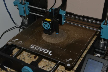

If you do have a place in the barn for it, where it's cold, build an insulated box around it and heat it up to room temp during the time you are using it. Let it stabilize. But it's nice to have a camera on it so you can watch remotely what it's doing.
Here I went down to my office since the camera that was watching couldn't see any of the first two layers. Had to use flash to illuminate the clear material.
