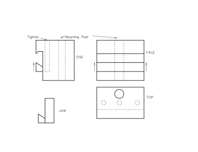

I'm thinking a plinth to replace the entire tool post with a dedicated 1" blade holder built right into it. At this time, the only real challenge is setting spindle center. Adjustments reduce rigidity, so I'd like to get around that somehow without losing the flexibility of being able to use various blades.
Lateral thinking? Centre height never changes, pull the clamp section up from underneath? Solid block, moving jaw from below, a slide or dovetail in the block. Project #42
Yes, exactly the kind of thinking I'm after. Allow me to add a few that might conflict with that though.
1. No good reason to have a vertical plinth. I'd prefer to make it curve down under the work to keep support as far forward as possible.
2. Same goes for L / R centering. I want to keep the blade over the middle of the cross-slide but yet leave room to clear the chuck and allow parting close to the Jaws.
3. I'd like a solid column under the blade. So I was thinking about a short fixed jaw on the front bottom and long rear top and moveable (tightening) jaws on the top front and bottom rear. Insert the blade on an angle and clamp the front top and rear bottom down.
