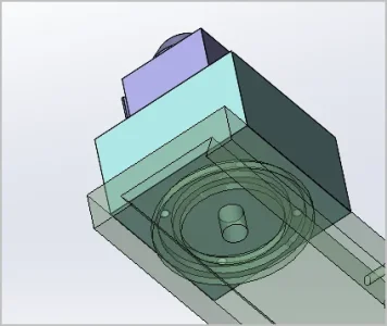

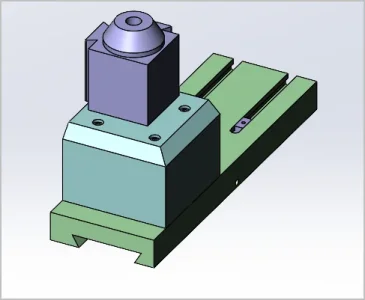

Yes, looking forward to discussion. I've come to the conclusion there will be times when I definitely want compound on, so the knockdown/install must be quick. Also I'm having dangerous thoughts again on a mounted mini-ish grinder spindle & I want it to move at angles, not just in primary 2 axis
I'm building one now, ha, ha. It is easy to switch over for me. I built a compound plinth before and it was a problem because I machined a T slot in it instead of putting in a bolt. This one will be like the stelster's. I found I put the compound back on once a year, but now I will try straight on threading instead of 29 degrees.
Post some pics @Ironman. I'm at the drawing board stage myself (again).
My original version was integrating solid block to my circular T-slot cross slide using 4 bolts. That allows me to mount my existing tool post & probably further stabilize with a corner angle thingy (not shown). Some guys dowel the tool post itself. But I'm thinking of something like 2 cam locks on either side of corner, like a Mitee Bite principle. I might be wrong but I think 75% of the rigidity win comes from just removing the compound from the stack up assembly - eliminating yet another layer of sliding surfaces & fits. Now that I'm mulling over a TPG spindle, I'm thinking maybe best to remove the tool post & mount directly on the block. I have time to think this through, I don't have any suitable material lumps anyways.
