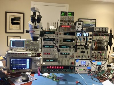

Be careful it's a slippery slope, on one of the electronic forums I visit one of the popular threads is the TEA thread, Test Equipment Anonymous(TEA) group therapy.
Common diagnosis is for GAS Gear Acquisition Syndrome.
Fortunately I have a mild case, some have it pretty bad.
Is that all yours? Holy CRAP! Some really cool stuff there. Especially that POJ Analog Randomizer in the bottom right corner. I have several of those. Incredibly useful.
Begs the question: What do you do with all that?
I sold a lot more than I still have, and trust me I have plenty of POJ analog randomizers ;-)
I'm retired now but spent most of my career designing electronics from the 70's on. Later part I helped companies commercialize their half baked or non-compliant equipment. I kept some basic gear because I continue to do the odd hobby project or respond to a few old but good clients. One of them from Texas still sends me a turkey every thanksgiving.

I'm closer to the back of the pack, check out these contenders from the TEA group.
I think that's a bit hilarious to be honest. That's a bit like one guy owning 23 mills and 17 lathes with no tooling.
I agree. That being said I think there are some parallels to machine tools WRT quality and serviceability of some of this older equipment compared to the new equipment. The ability to source some of this kit (especially when it needs repair) for pennies on the dollar also has some appeal. Almost everything in my picture was purchased as for repair or not working. Good quality old DMM's actually drift less than brand new versions of the same with the same references because they have had years to stabilize, just like a seasoned engine block is more stable than a brand new one. I just keep what I continue to use and sell off what I don't to keep the stack in check. I have found some people go on an on about how great a particular piece of equipment is and then I get one, fix it and find it's okay but lacking compared to some other similar piece of equipment, so it gets sold. When I can't reach it from my chair, the stack is too large and needs to be purged.

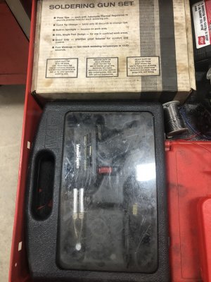

I’m going to have to go back and re-read this thread. The Weller gun is my go-to, the blue point is when I need more heat.
I’m commonly soldering 14-20 gauge wires, if it’s bigger than than I’ll usually just use a butane torch.
I haven’t had any luck with the pencil style torches, for what I do, they don’t seem to have enough heat
I’m pretty sure I’m using lead solder, rosin core. I don’t know anything about lead free solder, hadn’t even heard of it until this thread

No worries @Chickenlights.
Your gun is is just fine for electrical wires like you describe. And just as you have found, a pencil unit won't work well for that.
The pencil style units are for soldering transistors, resistors and integrated circuits. Your big gun generates too much heat too fast and would damage these delicate components.
On the other hand the small pencil units don't generate enough heat to properly solder big wires.
They each have their place. It's sorta like using a 3/4 inch ratchet on a #6 screw.
Lead free solder has been around for a while. It mostly an environmental thing. Very common in electronics and requires a bit higher temperature. If you have lead solder it's ok to use it to join wires.
