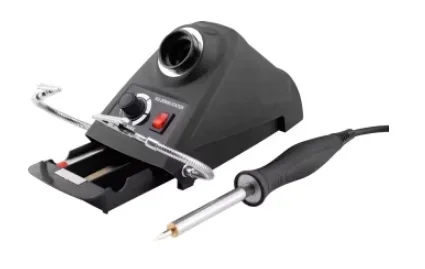

Much as I like the idea of a nice Weller with digital temperature control, they're a bit pricey (I know, relative term) for my needs. I picked this up a few days ago at Princess Auto... 40W, pencil style. Directions say to use upper end of the lowest range for tin solder, midway through second range for silver. I might try calibrating with my temp gun, but I'm not sure how reliable that would be.
I plan to use this to replace some dried up capacitors on some old PCB's. I've dug some junk PCB's out of garbage electronics to practice on, and so far, this little $25 special from PA seems surprisingly capable.
I've got a gun-style old Weller I've had for decades that I use for automotive type work.

I set mine at 700* F, seems to be a good point for current lead-free boards. A touch high for older 63/37 lead solder, but as long as you‘re not holding the iron on the joint too long it works fine.

I think my WTCPL is older. In the background we have 18g water soluable with pen, two no-clean 22g and 28g and one rosin core 20g. The tip lying on the sponge is marked with a 7 which means the magnet goes non-magnetic above 700 and switches off current to the heater. Once it drops below the magnetism comes back and switches on the heater. I really need some new tips. These don't tin well anymore.
Leadfree 710-725 depending on tip size. Much high than that the solder gets reactive with your tips and work, with the first noticeable issue being tip detinning, not letting the tip wet, preventing heat transfer and basically rendering the tip useless. Too much lower no flow.
Leaded solder 680-700, though withlead up to 800 is doable without to much adverse effects other than lots of cleaning on tips.
You will find with the digital/feedback control you'll get way better results as the iron compensates for the mass (heat absortion) of all the items involved during soldering to maintain the set temp.

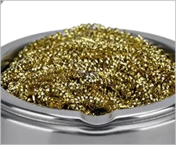

I used the wet sponge for a while but I prefer this style for small tips at least. The tip always needs to be clean & maybe doing it often makes them last longer? The tips aren't horribly priced & sometimes I'll switch from one shape to another. I've only 'worn out' a few & who knows maybe its the temp control internals that start to drift south.

Is that just a brillo pad?
It looks like one doesn't it. I'm pretty sure its a bit different. It feels softer, maybe thinner foil? The edges don't feel sharp like a Brillo. They have been around a long time. Now maybe there are knockoffs that feel different but I've had this one from electronics supplier for eons. You just poke the tip in a few times & it magically cleans. Every couple months shake out the bits.
I still use the wet sponge, no issues about 9lbs of solder on this tip already (and I'm none to gentle on my tip).

If your solder is old it's likely 60/40 leaded, if you dial up to 700F it will work well for a short while, and then the tip will oxidize and then it will work like crap after that.
Suggest 600-650 and see how it goes.
Ok I was using it at 550F last night and it worked pretty well. I’ll bump it up to 600F and see how that works.
