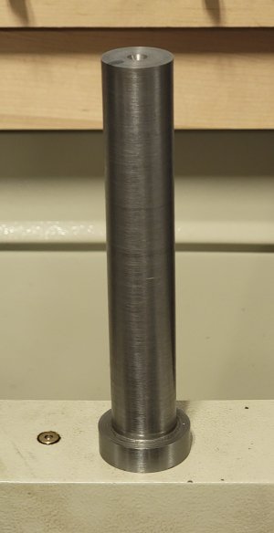

But surely it can't get easier than this. I made it out of a big rusty old bolt.
Here it is sitting on my flat way.

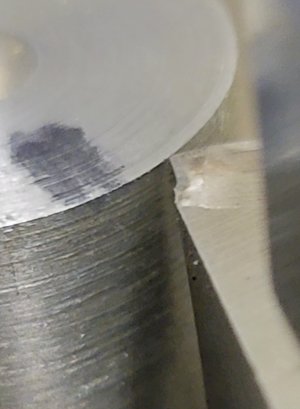

And here is a closeup of how you use it. Just rub your finger across where they touch. You can easily feel a thou and some of the characters on here can feel a half thou.
In use, nothing is faster or more accurate.

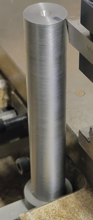

And just for the record, that's the high-speed tool I ground to make 12 thou needles for @DPittman. Needless to say, that job required very very very precise setting on center! I never did get to 10, but the opera lady didn't sing yet!
And just for the record, that's the high-speed tool I ground to make 12 thou needles for @DPittman. Needless to say, that job required very very very precise setting on center! I never got to 10, but the opera lady didn't sing yet!

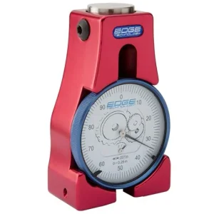

I really like this, though I suspect it’s because of the nice colour:
Edge Technologies Lathe tool height setter
It's cheap enough but the adjustment for non-level lathes ultimately introduces the same issue. First the tool must be exactly on center. Then you can tweak the level so it shows the tool is exactly on center. But to get the tool exactly on center you need to have the level tweaked.........
I like the colour too.
To be brutally honest, I hate the colour......

The level can be adjusted, to accommodate a lathe that’s not level.
The colour is looking even nicer the more I look at it…LOL

First image is what I use to set heights on the mill. Second one sets centre height on the lathe. Both units made by Edge Technology. If you buy the one for the mill there are two versions. I prefer the one with the larger touch down surface.

While I love the concept and look of Edge Technology products, the price and accuracy that they work to is somewhat lacking. Lower cost solutions (but more time and effort) yield can more accurate results which on initial set up directly translate into improved consistent results.
On the lathe I love the simple post gauge method, once configured for you lathe is quick simple and accurate, far beyond that of Edge Technology gauge.

I really wanted one of those Edge Technologies devices years ago but I could not justify spending the money on them at the time. I'm glad I did not spend the money because as you say, the alternative methods can be better and certainly alot cheaper.

I do agree with you about the tool for the lathe. It is not 100% accurate. There is a tiny amount of variation between tool changes. I'm not sure if this is in the interpretation of the bubble position or the tool actually being clamped in the tool post. It's usually accurate enough so that I have no nub left when facing. This is as accurate as I need on the manual lathe.
The height setter for milling tools is amazingly accurate. I can get it within the width of the painted line on the dial face. .0001". Completely accurate and repeatable. I use that tool to set up the tool table on the CNC mill. The unit has a gauge length of 4" and that comes in handy. When I need to calibrate a probe for example. I set up the reference height with the tool height setter and a master tool. I then remove the tool height setter and put in a 2-4-6 block on the 4" side. This removes any movement from the probe electrical system from the numbers when setting probe gauge length. Without using an electronic height setter it couldn't be easier.
