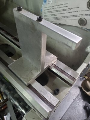

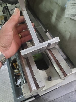

Here's what I have used. I first made the aluminum thing that sat over my ways but more recently I came across the height gauge and find it a bit more convenient in that it is adjustable and smaller.20220722_111612.jpg20220722_111619.jpg20220721_083750.jpg
That approach would work well for my South Bend.

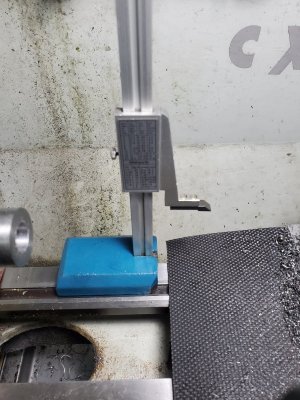

This discussion has inspired me to build a tool height gauge for my lathe . For the last 18 years , I’ve been using a cheap o height gauge , I can’t remember where I bought it, maybe House of Tools ? 61A0DBE0-5068-43F1-849C-7BF9A7F68F9B.jpeg
Mine was BusyBee too. I still just use the vertical piece of metal to adjust too height. Sloppy I know.
Any method or setter works, biggest secret is always reference off the same surface once the tool is set.

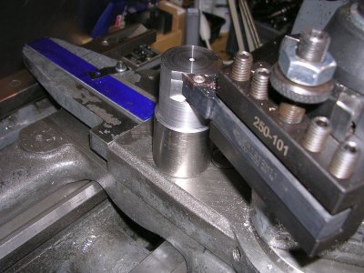

In my case I have a piece of chrome moly that I've turned to reference off the carriage cover (it is stiff and flat) and lets me use the cross slide in any position. On my previous lathe it was off the flat on the bed ways (not a convent spot on the new lathe).
