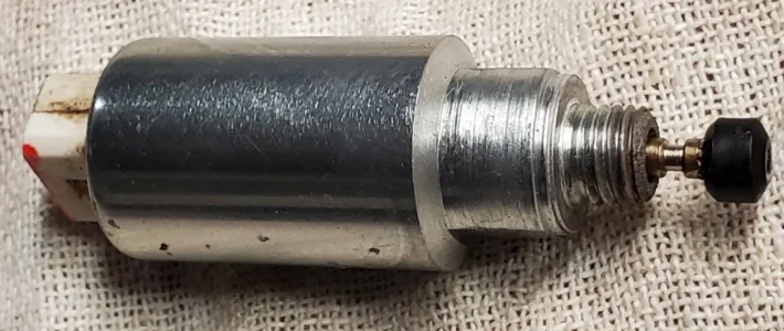

Amazing. After a few hours in the rust remover with periodic removal and air blast etc. the plunger now behaves as new. Now 12V on and off causes it to retract and return reliably.
I've tried to cancel the one I ordered. No idea if I will succeed there. But given how nice and clean the carb is now I think I can try it out tomorrow. Even found the little o-ring I blew off with the garden hose after I rinsed the carb cleaning fluid off it on the concrete patio.
Feeling slightly successful...
Rather than buy a new solenoid I put a ball valve in the fuel line and just try to remember to shut the fuel off after mowing the lawn.

Although I understand that the spring in this solenoid might be weaker than new the top cap is either hardened rubber or plastic. What it goes against is also just the plastic bottom of the float holder assembly. The ones on Amazon.ca don't even show a plastic cover but metal as in the photo on message #88.
Above that in the plastic tube is the jet with an o-ring around it. It's just pressed down to the bottom of the plastic tube. The solenoid end doesn't even touch it.

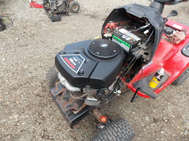

Well I got a tiny bit of lawn cut after I mounted the mower deck. Then by mistake forgot to disengage the PTO. Pressed on the brake and shifted to reverse to back out of the corner I was in. And it stalled. And after that it wouldn't start anymore. It turns over fast enough. I can feel suction through the carb when I remove the air filter. Did not check for spark. The three safety switches I know of were both properly activated. Maybe it flooded.
Have to take another look tomorrow or Thursday. Got a couple of classes to teach tonight. New fuel and air filters arrive tomorrow sometime too.
OK. Rookie mistake except I'm not exactly a rookie. Today I first checked the REVERSE switch. It's fine. Then dug around on the network until I found a decent drawing and also some info on the reverse switch.
Next with the engine cold now I pulled the spark plug. Or to be more precise I moved the spark plug cable and boot off of the spark plug. And yet it was a bit wet inside so that implied no spark.
Seeing as the cable came off so easily I took a look inside to see if the inside of the boot was dirty or had corroded or was enlarged and therefore not grabbing. Nope.
Pushed it back onto the plug.
Hmmmmmmmmmmm. That didn't really click on very well. Took another look.
Hmmmmmmmmmmmmmmmmmm.
Pushed it back onto the plug and then really pushed.
click....
Hmmmmmmmmmmm.....
Idiot!
Spark plug wire was never tightly clipped in place. That's why it slid off so easily. That's why the slightest bump moved it away from the spark plug and engine stalled. And then wouldn't start....

Ah. That explains it. Plunger should be spring loaded against the inlet hole then. Power applied and plunger should pull in to then allow fule to fill the float bowel which I thought was there to prevent fuel from flowing if the engine isn't running.
The carb is soaking in the cleaning fluid now. I've washed the inlet and outlet pipes. The float and float assembly have all been cleaned. If all goes well when put back together should theoretically not surge...
