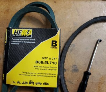

Got to the point where the tractor would barely go up a slight incline in 1st position. I asked the original owner when he'd replaced the two transmission belts and the answer was never. So clearly over 10 years old worth of V Belts. The photo makes it look better than it really is.
Princess Auto had them. Put the small one on that runs to the variable speed pulley. But to do that I had to remove the tension spring. On a Youtube video the guy suggested a hook formed on the end of something to pull the spring back out through the hole.
Nice to have Oxy/Acet available. Spring pulled out and latched easily. Now I can mow up a slope at #3 where two weeks ago it would barely do it at #1. And I can mow on that slight incline faster than I dare.
I have to drop the mower deck and remove the motor pulley to replace that longer motor to transmission belt. Maybe tomorrow.
