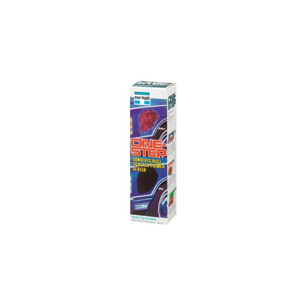

Whether I repair with lots of money or lots of labour or convert to electric the one key thing is the deck has to be in decent shape. Other than some rust on one end it looks not too bad. I'll pressure wash it and then I'm open to suggestions for what kind of rust covering paint is appropriate.
I have an unused 8 oz bottle of mar-hyde One-Step rust converter. The number is #3511 but it appears that's no longer a valid number.
Epoxy paint?
After I pulled the blades and sharpened them I took a scraper to the thick mulched mud that was stuck to the inside of the deck. Then pulled out the big Craftsman Angle grinder and my huge cup brush bought to handle rust on my old 1964 MGB back in the early 70's. Between sharpening the blades and holding onto this grinder I didn't last long but I did get a bit cleaned up. More to be done. Probably an hour or so of wire brushing. Then a power wash. Once dry I'll try that rust converter sealer.
I've had good success with a graphite based spray-on coating on top of the original paint John. As long as you are painting your deck, it might work for you too. One aerosol can is enough for a big 62" deck. Usually I have very very little accumulated clippings under my deck. What is there comes off in 2 or 3 minutes with a homemade softwood scraper. I'm not even sure if it should be removed. I've seen it all come off on its own when I use the deck next. I think the deck has to be spanking clean (or newly painted) before applying the graphite.
