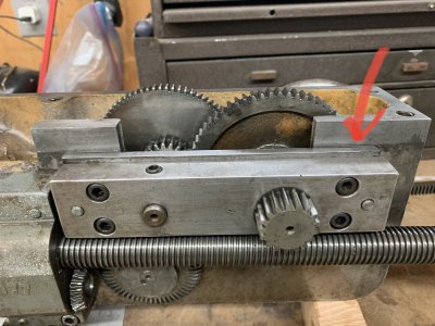

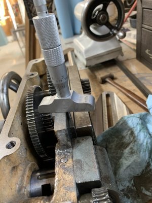

Today was awesome and I needed to resurrect the old thread to add some information. Since the big rebuild I have been waiting on making a few more gears and just getting things dialled right in. When things are going well I can get the lathe to less than 0.0005” over a foot or more, and yes I can be picky - hahahahaha -

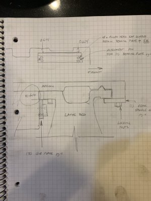

One thing that was bothering me was that when operating back from the headstock, near where you might start a cut on a longer shaft type thing I noticed that when I started to advance the saddle of the lathe it would slightly lift or deflect at the front. I thought this very odd - especially since I still was getting decent cut results - most of the time.
The second thing that bugged me was the play when advancing the apron. If you were threading the hand wheel would sometimes rock back and forth making little bumps.
Before heading to work I thought to just tear things apart and take some measurements- then the epiphany!!
when rebuilding the lathe apron there is a plate (page 13 part number 3) “Gib Plate” but nothing more is referenced.
It is indicated by the red arrow:

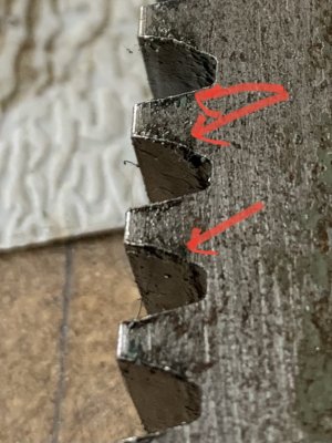

So with Spidey Senses tingling I did some measuring. Well- Ha! One side (back side) was 0.614” and the front was 0.624 - Interesting— so then I measured under the lathe from the machined surface of apron to the lathe bed and got an average of 0.610 with a bit of wear in spots but not bad. So “GIB PLATE” - light bulbs all coming on —— I loosened off the 4 Allen Head bolts and adjusted the GIB PLATE to be 0.612” front and back. Thinking 0.002” clear would be OK.
Then comes the second light bulb - way back when, @YYCHobbyMachinist bought a lathe in Ontario and @Chicken lights and I transported and shipped parts all over. One thing I kept back was the rack for the pinion that the hand wheel drives to advance the apron. Couldn’t be the same .... IT WAS !!! Ya baby - and it was pristine after an hour of scrubbing - compared to the one I had original on the lathe. Also the original had a bum retaining screw hole that would loosen from time to time - note the wear and raised edges:
So with all that changed out I adjusted the locking nuts on the Rear Saddle Gib and checked the fit of everything else - WOOO HOO! Less than 1/2 thou deflection if that and the apron was running super smooth! Still some play in the hand wheel but way way less - Excellent!!!
Here is a diagram that may help with clarity. The rear saddle Gib is mentioned in the manual but nothing about the front one.
Super cool - grabbed some other measurements for future projects - like a ball turner :). Since my other posting about black nuts was well received I figure a brass ball maker can’t go wrong :).

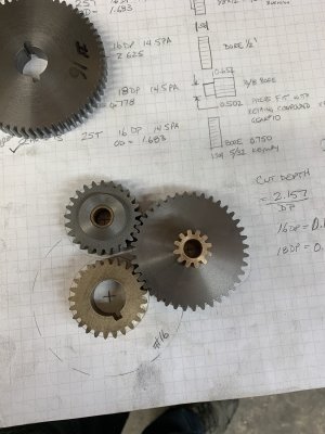

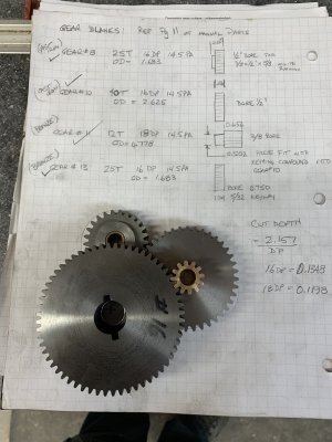

And the feed gear parts are finally done. Lathe is working fine with the present gears but I had the blanks and needed to get this completed.
The wee 12 tooth 18 DP bronze gear is loctited and pressed into the larger cast iron gear. The ID was then reamed to 0.375”. The grey gears are all impact resistant ductile cast iron and the gold gears are all bronze, I think they are 544 high stress bronze for greater wear resistance.
I have a couple more gears to finish for the outer drive but those are 20° pressure angle and, alas, I do not have those particular cutters - yet!!! BAHAHAHA.... cough cough -

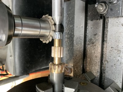

Thanks guys :). I found that the “Chinese” cutters seem to have a few out of round issues - maybe a couple thou. To combat that I make sure the depth is set to the cutter tooth that just touches the work first. You will see a bit of the “chatter” type pattern in the wee bronze gear. The gears mesh well so things must be going ok - LOL.
I had the rotary table set up in the mill so finished off the gears I could as I need the mill for making a few other items - ahh the fun!!!

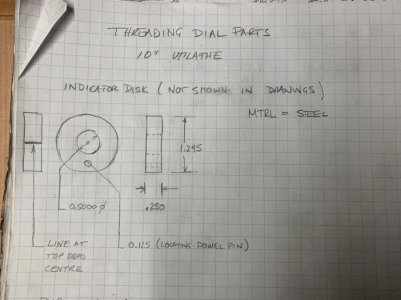

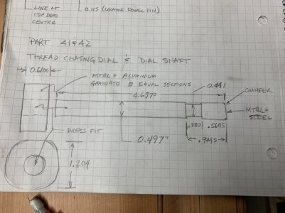

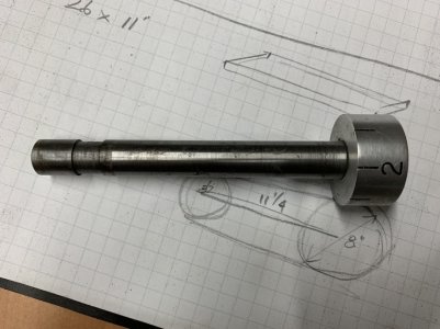

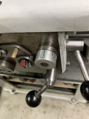

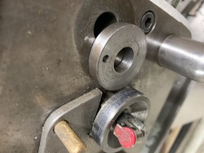

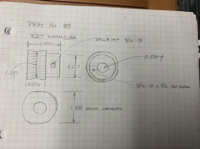

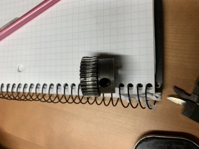

Here are some pics and drawings of the threading dial assembly:
@Salem747 : that is what I have for you at this time. Hopefully that can get you on track.
Oh snap! So that gear runs on the round shaft AND the spur gear! Wow. I wonder if lablonde can make this.
How do you index it? Hmm.
Actually only the lead screw engages/drives that gear.
The picture above makes it seem as if it engaged both the carriage rack above and the lead screw below at the same time. It does not.
Ok, I wonder why they shaped it that way, maybe to engage the round lead screw better?
@Salem747 : the gear (#39 in the manual) is a worm gear and rides on the lead screw. On the Utilathe the lead screw is 7/8” diameter and 8 threads per inch acme. The worm gear (I will have to check on measurements etc is a 24 DP 14.5 PA.
To index it properly, (do this at the tailstock end of the lathe as you can tighten the set screw on the gear). With the set screw loose, move the apron until you can engage the thread handle. With the thread handle engaged, rotate the thread dial to a number. Once on the number, tighten the set screw securely. That should set your indication.
