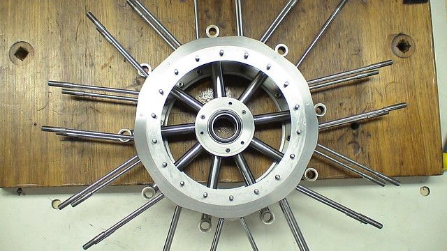

With my modified tappet guides, rocker box & pushrod tubes nailed down its now rinse & repeat time. 5 cylinders times 2 per + 1 spare (just because) = 11 total. Thought you might be interested in sequential operations all done in one chuck setting so everything is axial. The guides are C544 bronze. The body OD is 6mm, fits 5mm hole in crankcase, 3mm reamed hole for tappets. The cutters are Nikcole, kind of spendy but last forever & I've used them for many aspects on this project. The round profile matched my 1mm section O-ring. Hopefully pics are self explanatory, otherwise just ask.

The radial requires (5) gasket seals under each cylinder flange and (2) for the crankcase front & rear. I found some 0.003" thick teflon sheet from Aliexpress. By making a CAD template from MDF I was able to score through & cut the inner/outer shape no problem. But making clean holes for the M3 bolts required a tool because drilling just makes a tattered mess. I didn't want to make a matching plate to kind of die punch it so came up with this. Its ~3mm O1 tool steel but the end is relieved by a ~4mm ball end mill which gives it a sharp peripheral edge. I decided to harden it, I didn't bother tempering. So I just spin it through the template over one of those cutting mats & out comes a clean little confetti dot.

I debated hardening the rockers because of the axle hole & M2.5 threads & skinny asymmetrical features (potential distortion or cracking). But the hardness of annealed O1 is only a point or so higher than 303 stainless (valve stems) so the thought of wearing the rocker pads I spent to much time on was enough to vote for harden. The tops of the valve stems will preferentially wear, but no problem there.
I didn't take any pics while heating but I was able to focus the torch on the pad segment & just let the heat flow backwards. Once the pad end was carrot red for 10mm or so, in the quench oil it went. So the other 70% will not be fully hardened but that's fine, desirable actually. I buffed off the black & tempered at 450F in my (shop) toaster oven. No noticeable distortion, everything fit nicely.

My prop arrived from China. Eventually I'll laminate some veneer & make a cool antique profile but this one will do just provide load & blow air on the test stand. Unfortunately I realized the plans assumed a bit thicker prop hub thickness. This one is just under 20mm. So that started a domino effect annoying re-makes. I had to make a thicker drive washer to compensate. That felt a bit overly meaty, so I also drilled some radial lightening holes. But the added thickness then required a matching brass tapered split bushing, so new one of those too. Then a jig & alignment pin to drill the prop screw holes. Well once everything was mounted it was fun to twirl the prop & watch the rockers & pushrods doing their thing.
