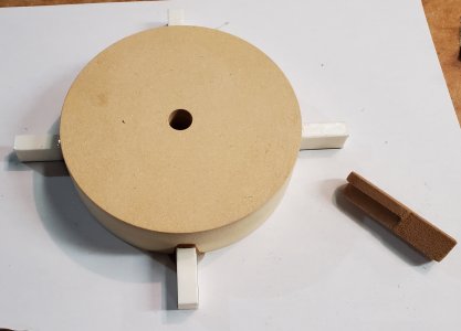

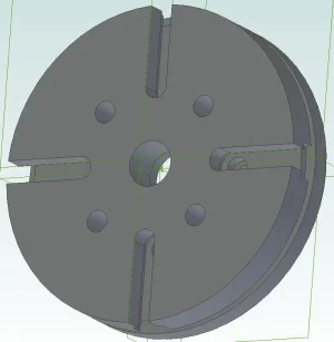

In case anyone is interested in the mixing of 3D print technologies with green sand core based casting here is what I'm trying to make:

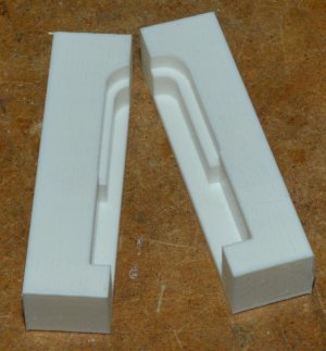

I thought it would be interesting to make T-Slot cores so I 3D printed the core box.
Now the core mixture gets packed into this and then the core box is split and the compressed part laid on a metal plate destined for baking in the oven.
One baked. Three yet to hit the oven. To avoid having to drill a hole and since the pattern (unfinished here) has a hole in the center I need a core for it too.

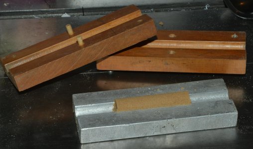

I still had the core box from the Gingery Lathe TailStock:
So I made a short core and baked that too. The cast aluminum core holder was to help keep the core round in the oven.
I've yet to put glossy paint on the pattern and although the primed version pulled nicely from sand I think I have possibly made the draft backwards on the cores.
