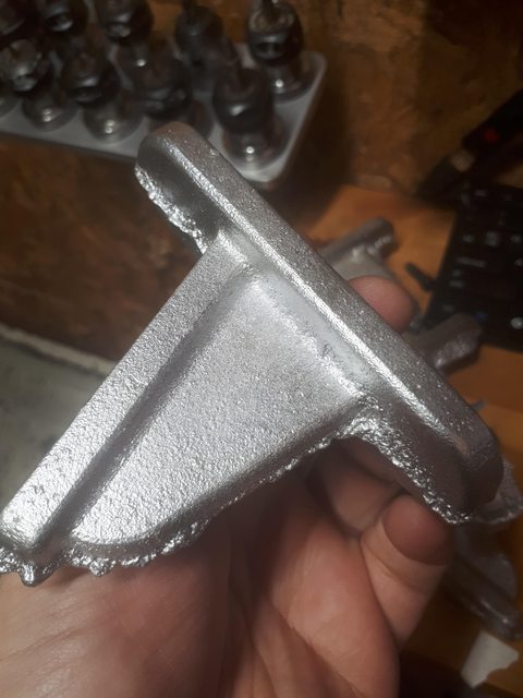

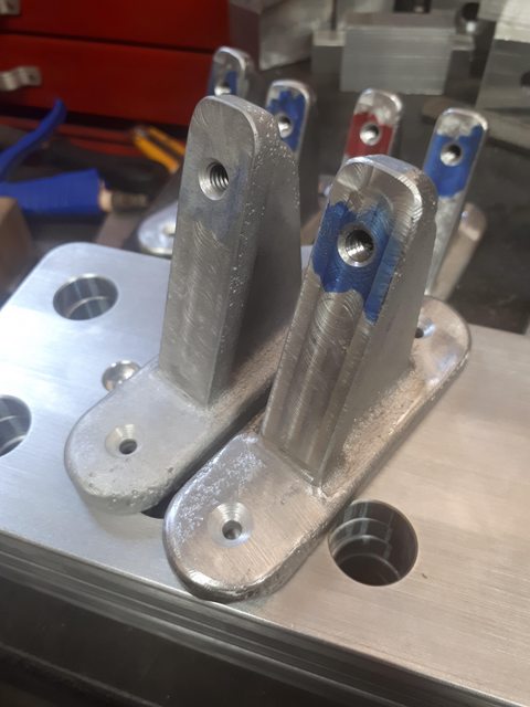

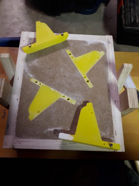

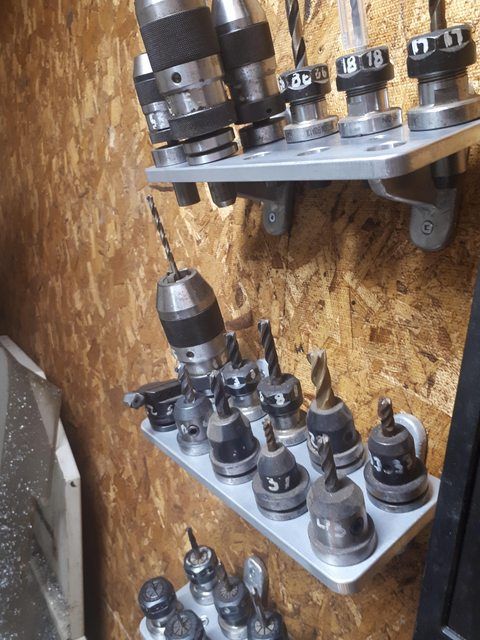

This is one of the last projects I did. Brackets cast from 3d printed (unfinished patterns) to make some mill tooling racks.
It was an exercise in seeing how quick I could go from cad model, to 3d print split pattern, to cast part with as little human effort as possible. I learned a lot, and have made improvements, but it's a pretty damn quick process for rough and simple parts like this. Better finishing of the patterns, yields much better results, but not everything needs that high of quality. There is a point of diminishing returns, and I found a pretty good workflow for simple shop projects like this. I need to cast a few more of these brackets again.

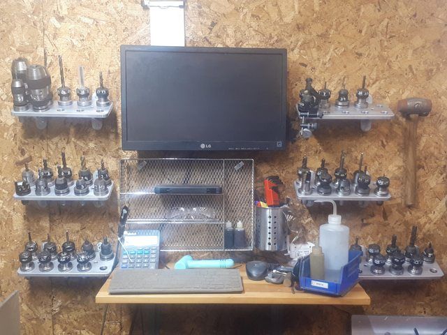

Wow Dan. You can really crank out the work. Are those numbers on the holders tool table id's? offsets table ids?
I get stuff done in small batches of free time when I can, but my shop and in process projects can gather dust for months while I get busy with other stuff. I didn't get much done at all this year to to a variety of reasons, but have this weekend free to catch up on some things. It comes and goes in waves and I tend to make it worse by biting off way more than I can chew at times..........
Those brackets were done about 9 months ago (according to my imgur upload date), and it seems like yesterday. I went to cast some more about a month ago and discovered my crucible was too worn for me to trust, so I ordered another one. It's taken that long to get around to casting some again. That's a pretty typical timeline of how projects go around here lol.

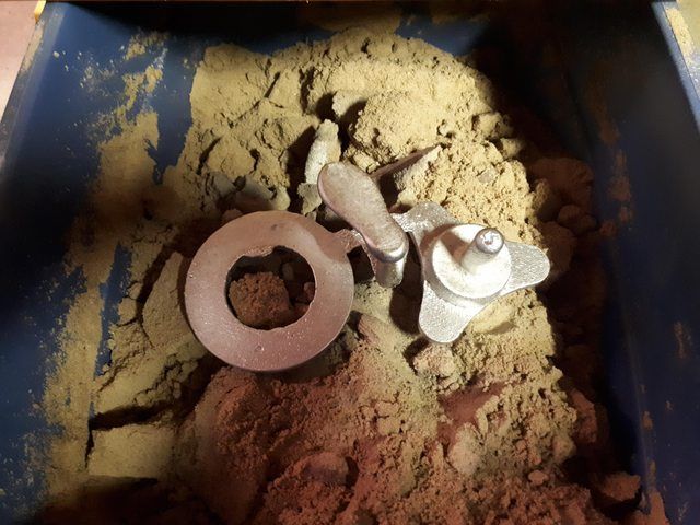

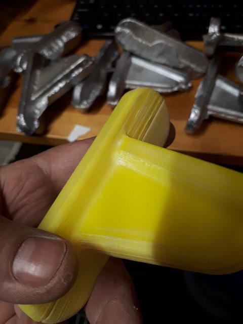

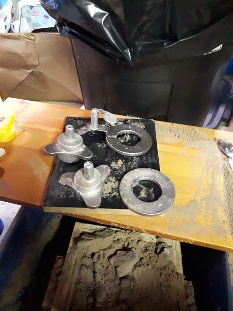

I have another similar project I did where I wanted to make a quick and dirty print to casting, and after I cast them I took the time to sand, fill and paint the printed patterns as I wanted to see the improvements to gauge whether the time is worth the effort for stuff like this, and get a sense of where the effort is worth it.
Stupid me though, those parts aren't something I needed more of lol. I should have done it with the brackets, and at least I would have had extra parts I could use. I only needed 4 of these hubs, and got my 4 the first time around. Then I spent an hour or two (total over a few nights) sanding, filling, and spraying multiple coats of paint on them. Sometimes I wonder about myself.....

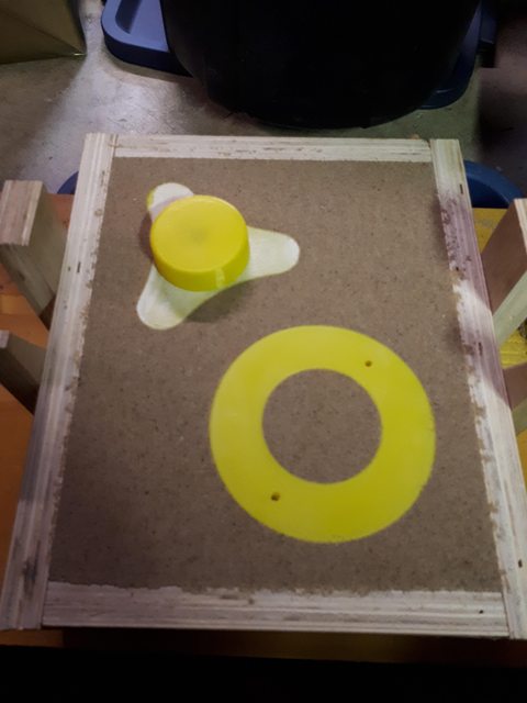

They all came with the Tormach when I bought it, but I have added/made a few more since.
It was a symmetrical split pattern. I have yet to do any lost PLA/foam casting, but would really like to try in the future.

Nicely done. Registration pins. The whole works.
