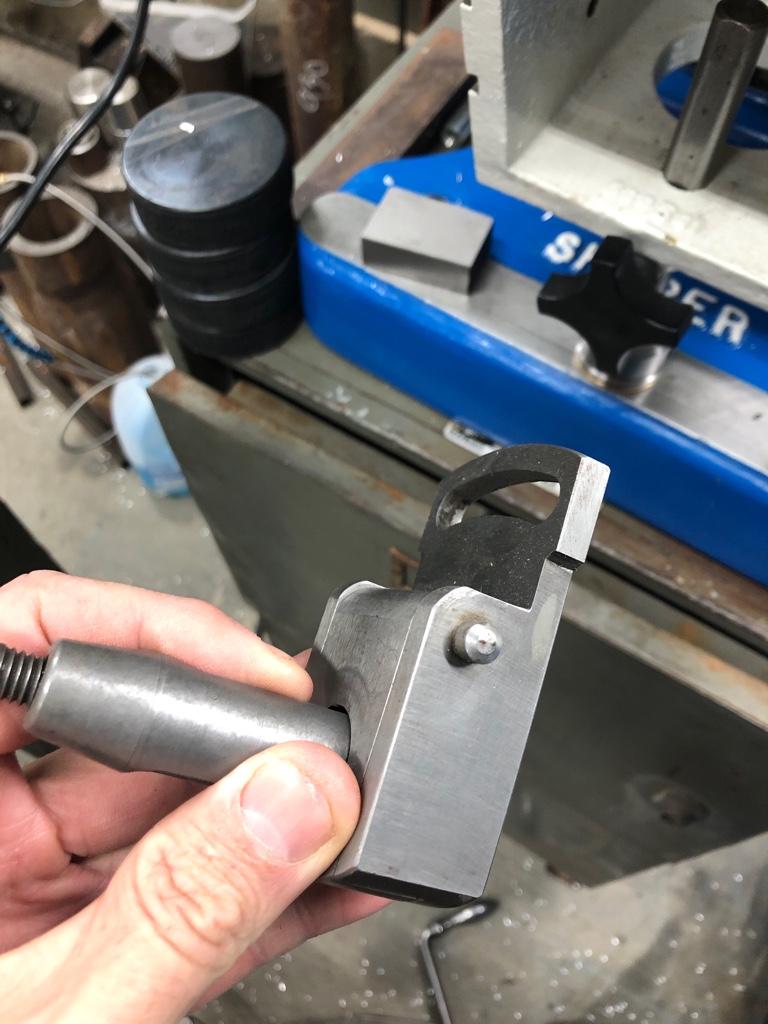

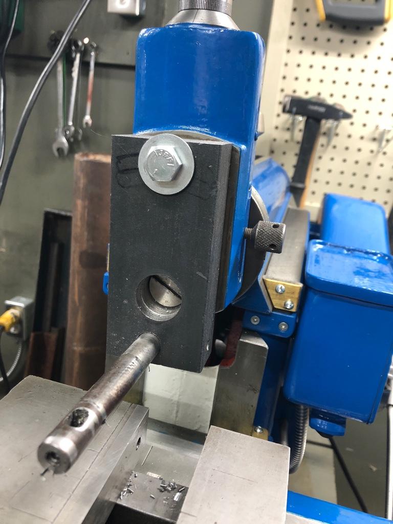

Some pics from the southbend, I have replaced the clapper box
Here is the clapper

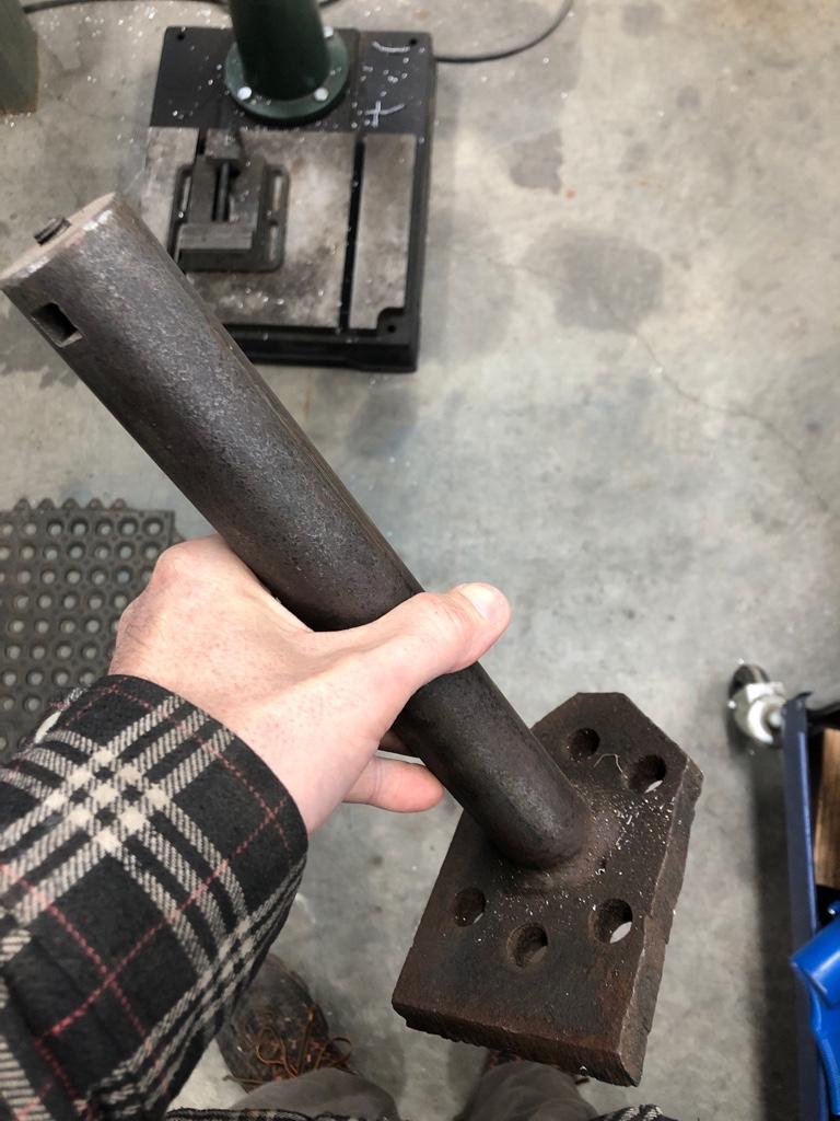

And on the big shaper, the boring bars I got with it were all homemade, and welded solid

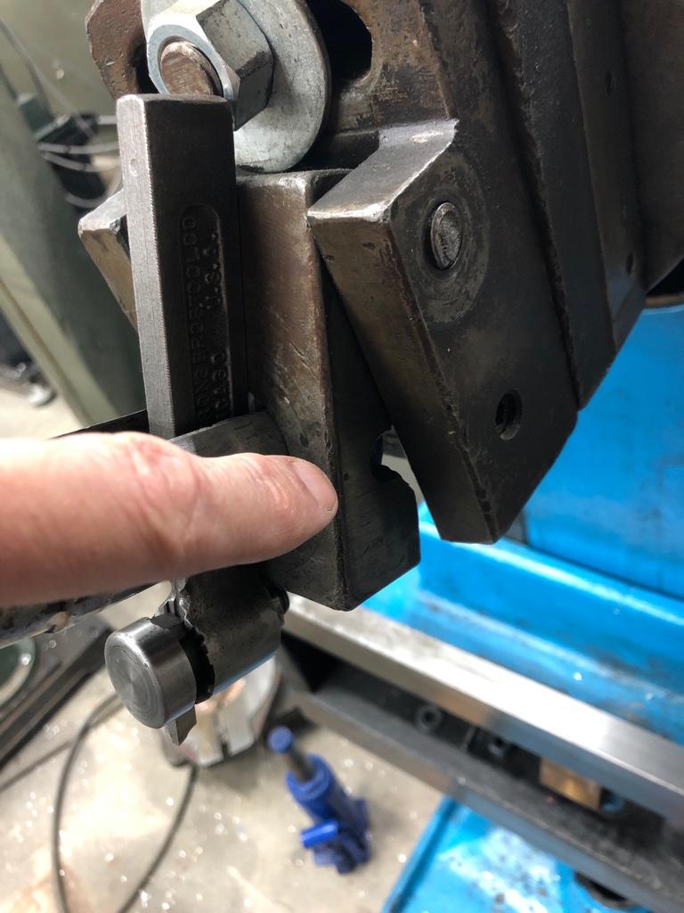

The clapper on the big shaper had a hole for a locking bolt on the clapper but the casting was blown out on the clapper box
I don’t like my south end setup, I’ll be making solid (welded) boring blocks for it too for rigidity
