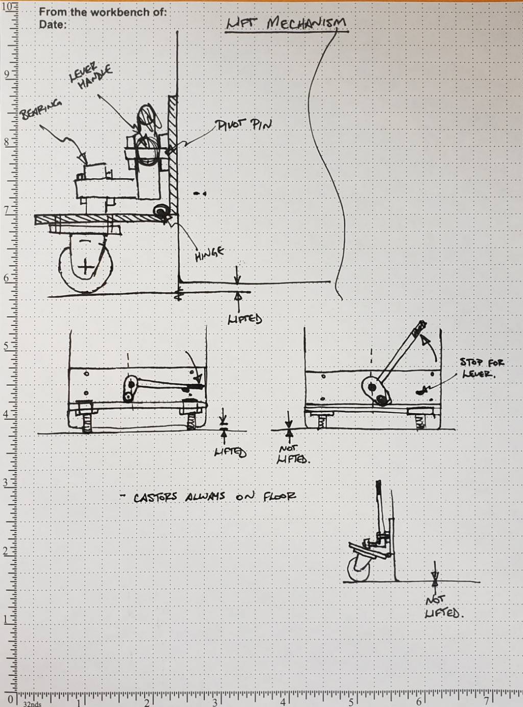

One simple and cheap-ish option is to purchase workbench retracting casters, often associated with woodworking benches. These may have been mentioned already and I missed it. These are 4 individual units placed at 4 corners with swivel casters built in and a lever per unit that you step on or flip up with your toe. Available on eBay, Amazon or Lee Valley.
Another option is to use similar principles like the above in a slightly different way. Years ago I had a heavy machine by home woodworking shop standards, not so much by metal machining standards (< 1000 lbs). This machine needed to move frequently but absolutely needed to be rock solid when in use so we built a lifting mechanism for each end of the machine that bolted to the cabinet side which happened to be 1/4" plate.
I've sketched the idea so hopefully it makes sense from the drawing. It's not shown, but these were non-locking swivel castors. In my case we used some cheap units from Princess Auto but rated at about 500 lbs a piece. That meant the unit would start to roll when you thought it was perfectly still on a pretty flat floor. Easy to move, but the tool needed to be dropped to the floor for sure when you weren't moving it.
I'm sure this wasn't a new idea, but I had never seen it before we built the units for my machine.
Cheers,
Kirk
Sent from my SM-N960W using Tapatalk
88hillman
Member
I forgot to mention, the cam (bearing in this case) needs to go slightly over center when the machine is lifted so you don't need another method to lock the lever in place.
