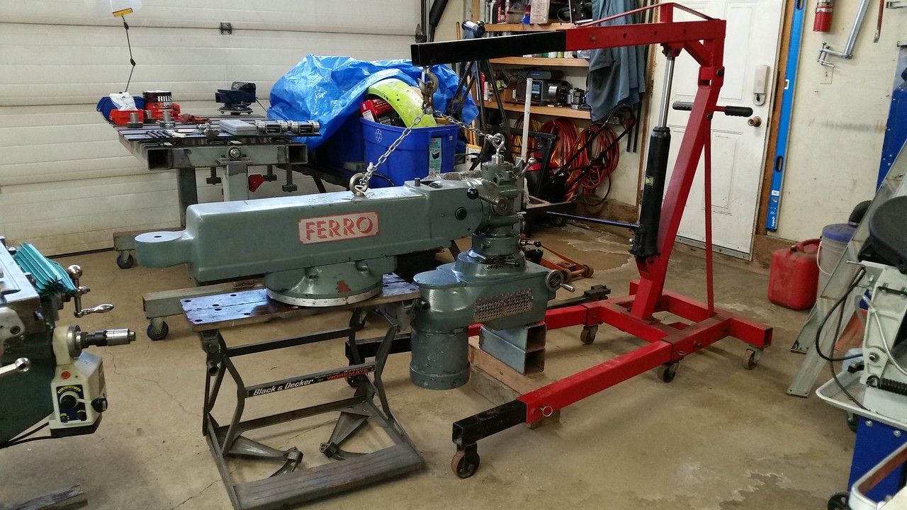

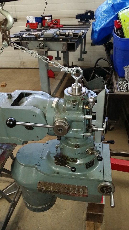

In all the very old BP manuals, it shows a big red X about lifting the entire machine by that eye bolt. The ram is about 1/2 - 5/8 " thick at the eye bolt, so it is a iffy lift at best. I usually lift using a pair of staps on both sides of the ram when lifting a whole machine. - and even that has it's pucker factor.
lifting the an with the motor on can be done, but here's a much easier, safer, and quicher way, especially when considering reassembly:
If you know how, take the head assembly off the ram. (more on that if you like)
Position the eye bolt over the centre of the column, and then take the ram, dovetails and the roating assembly off in one go. It is simpler, easier, and quicker to reassemble.
It is done by accessing the spider through the access door, and removing the bolt. (and then you'll see why it is dodgy to lift a 2400 lb machine by the eye). The rotating assembly will come free, and the lift is easy and balanced.
The PM manual shows lifting the entire mill by the eye bolt, it says the eye bolt is 3/4 10tpi. It also shows lifting the Dabbler describes. As Dabbler said It is scary lifting that much weight no matter how you do it. If you are just removing the head and ram to access the spider I found it easiest to invert the head 180 degrees and put a 1/2" eyebolt with the threaded part cut off in a collet. This allowed the bulk of the weight to be carried by the ram eye bolt and I was able to keep the ram level with the right length of chain to the spindle eye bolt. I think I would repair the spider with thread insert like a Heli-Coil or Time-Sert

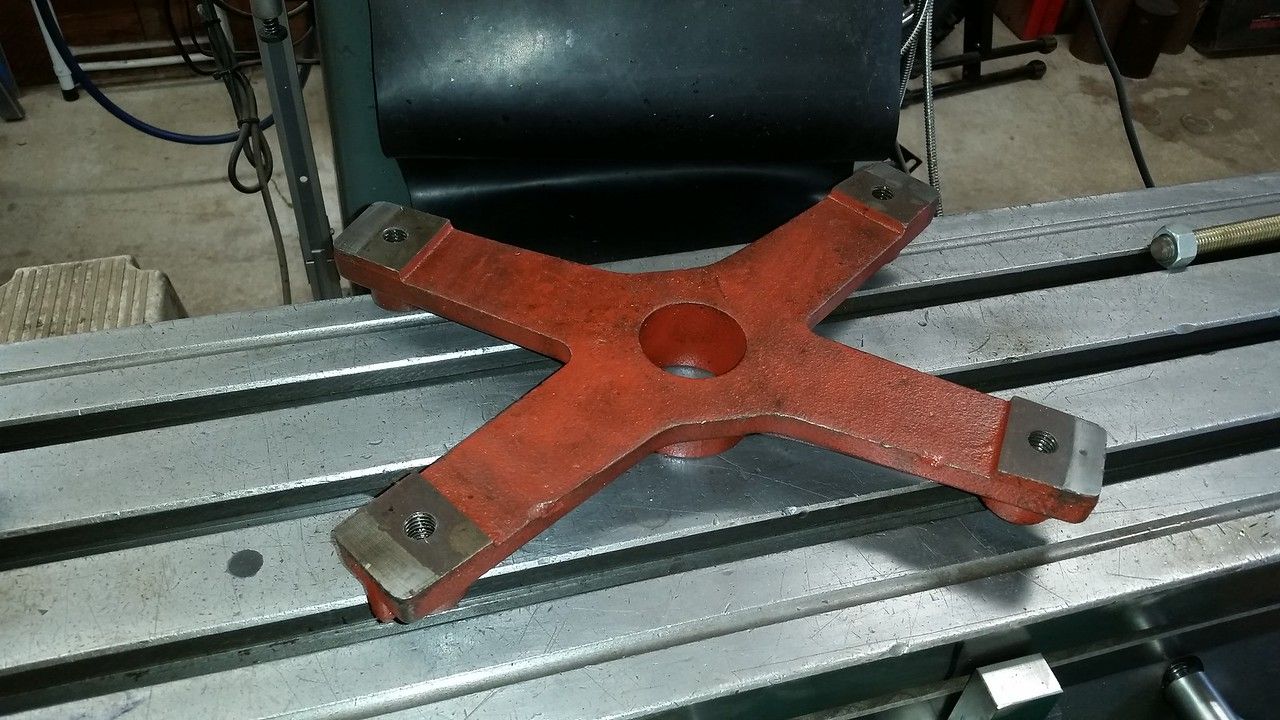

The "spider" that the ram bolts thread into looks like this.

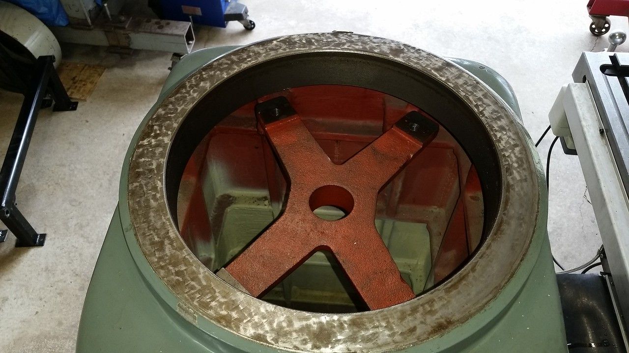

My apologies for getting the parts and process so wrong. That's what I get for jumping to conclusions. There is a door in the side of my Hartford Mill that provides access to a storage area inside the mill base. I opened the door and then took a picture of the turret mounting system from below. Here is the photo.
My first mistake was to assume that the Hartford and the Bridgeport were the same.
To my eye, It looks like there are four tiny ledges in there whose only job is to hold the red bracket (spider) in place until the four turret bolts are threaded into it. Thereafter, the spider turns with the turret. But should be put back into the ledges for removal.
I do not see a threaded rod to hold things together. But tben again, it's a Hartford, not a Bridgeport. I will figure it out.
But before I do anything like that, I'll remove the motor and head. That way balance on the ram is not an issue. But regardless, I do have a leveler for my engine hoist that I can use to keep the ram level for removal and reassembly.
In regards to repairing the spider, I had assumed that it was a forging. It's a little hard to believe that they would use a casting for that. But then again...... If mine is cast iron, I may simply make an all new spider out of steel and weld on four new nuts. But that's just a thought. First I have to get it out and then take a good long hard look at it.
The only difference between the Hartford and the BP was that in the old BPs I took apart there was a central bolt/nut - but my Hartford looks exactly like the ferro that @John Conroy owns.
If the ram is retracted, the spider can be removed by taking out the 4 bolts. (I wish some told me that the first time I took apart a BP mill!)
