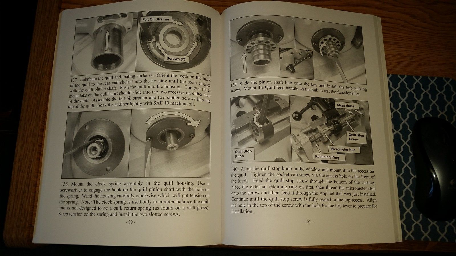

So....... Anyone know what the proper procedure is for preloading the clock spring?
It looks like someone put the 2 keys together to try and replicate the correct key that maybe got lost. A #7 woodruff key would likely be correct as it is 1/4" taller than a #3 woodruff key.
Instructions to install the clock spring from my manual.

I admit that I am surprised to learn that the clock spring is not supposed to lift the quill - just balance the weight. I would never have guessed that.
Thank you for the manual photos.
Yes that is interesting. I always thought my BP clone was sluggish on the return up. It doesn't stay in equilibrium, it does raise on its own (slowly). I guess its supposed to be this way for some reason. My only prior data point was my prior RF-45 mill which retracted quicker, more like a drill press.
Couldn't find a woodruff key today. Nobody in my part of the world had any stock. So I made my own on the lathe and then cut it in half and ground it to fit better than a purchased one would have. It was fun!
Installed the clock spring as per the instructions. 1.5 turns worked about perfect as a counterweight.
