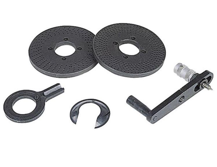

I have a spare set of plates and all the fixings for a 10" RT that came with the loot when I bought my lathe I have no idea why there were 2 sets if anyone has a use I'll post it on the correct thread. Proceeds to the Forum.
What do you mean by plates?
Dividing plates like these that like a person index the rotation of the table.
Turns a rotary table into a pseudo dividing head.
The dividing head plates to use on a rotary turntable to give you more accurate hole placement say for some unknown reason you required 17 holes on a work piece accurately placed the only way to achieve it is by using dividing head plates. Don't get me wrong I am not fluent in the procedure myself and can not quote you the exact procedure/settings. I have to do it with the instructions in one hand to even muddle through it. Thus the reason I'd doubt I'd wear a set out and need to keep a spare set lol. And no they do not come with the tables but they are available on line.

The previously mentioned 17 holes hypothetical on a 360 deg. arc is 21.1764 degrees between holes could never be achieved using the supplied reference points on your turn table the dividing plates will enable you to accurately do this.
Dividing heads I can get my head around:p Adapting indexing plates to a RT not so much:confused:
The plates attach to shaft that holds the handle used to rotate the table.
The handle is removed, the plate is slid on and screwed into place, the sector arms are slid on and then the crank handle is attached.
Not at rotary tables can take dividing plates.
When I bought my table I gambled and bought the plates and table separately because it was about $50 less expensive. As it turned out they plates, sector arms and handle fit perfectly.

Strictly bolt on option. I will measure the set to provide required information in a separate thread in the "buy & sell".
