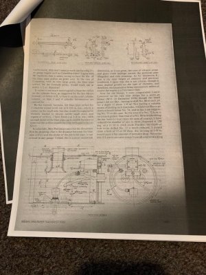

Hi All,
Nothing like re-inventing the wheel!

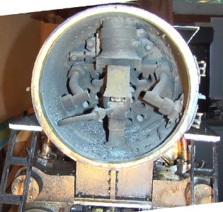

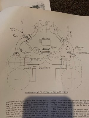

Photo 209 shows the overall blast pipe exhaust design of Laurie Lawrence which was used and modified by Martin Evans in the design of the Columbia Northern (photo 210). Laurie, subsequently, had some criticism of the Martin Evans modifications all of which are documented in the Model Engineer articles.

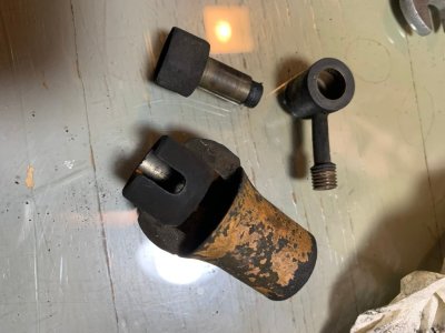

To add to all of this, I have an unknown locomotive cylinder assembly, photos 212-213, which employs a somewhat different construction technique than the preceding two designs in order to eliminate any silver soldering of the various components (i.e. an all bolted/threaded assembly).
So, to re-invent the wheel, I will employ elements, which I like, from all of the above three designs in the blast pipe assembly which I am going to make.
to be continued.

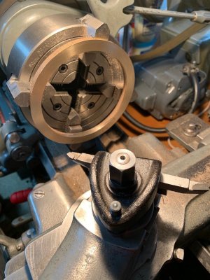

Hi All,
The start on the lower blast pipe assembly body. This is being made from a 1-5/16" dia. x 5/8" thick piece of bronze round bar. With the price of any metal these days, especially for a metal like solid bronze, it could have come from a jewellery store.
The through hole internals consist of a 1/2-32 TPI ME thread to screw on to the end of the blast pipe and a concentric 20 degree internal taper. So to be as concentric as possible after rough drilling, the thread ID section was bored to 0.468"dia. to give an 80 per cent (very close) thread engagement. The 20-22 degree included angle (as per the Laurie Lawrence drawing) was then concentric bored to this thread.
The problem was, when boring the internal taper, one could not see or measure anything that was going on at the bottom of the hole. This is critical as there has to be a smooth transition less internal taper as shown in the drawings all the way through the entire blast pipe assembly. After doing some head scratching, I came up with the inked taper plug as seen in photo 215. As boring of the internal taper proceeded, I rotated the plug against the front face of the taper hole and noted how much marking blue was being rubbed off. When the end diameter of the plug just barely showed bare bright metal, I stopped. I hope this works. We shall see.

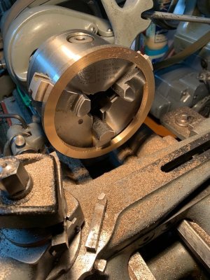

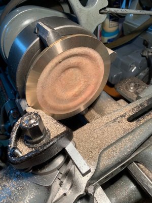

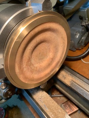

Hi All,
Proceeding with the machining of the other side of the lower body piece. This involves forming the circular steam channel. Photos 217-218 show the laying out and the machining operation involved.
The issue began when I ground up the first form tool from a piece of 1/4" square HSS. There was a lot of grinding involved and it did not work at all. It caused the cutter/part to chatter and to dig into the work. Then I remembered the form tool made when building the Quorn T&C grinder decades ago to do a similar operation. This second (successful) form tool is shown in photo 219. It is quite different due to the problems of producing an accurate narrow, "deep" slot. The slot itself is only 1/8" wide and 5/32" deep. Because of this, the form tool has to be kept to a very narrow thickness (less than 1/8" thick and only 3/32" wide) tapered on both sides, given top and a generous front rake plus it is a 1/4" long. The reason for it being so thin is the bottom of the tool will rub on the outer wall/diameter of the circular arc if it is made any thicker. The form tool also has to be kept exactly on the centre height of the part or a shade lower which makes things even worse and tool clearance was an issue as well (photo 220). I guess I could have employed an annular cutter but I don't have any and I doubt they come in a size suited to this particular slot.
So given all of these constraints, how did the tool even function at all? Same old story; absolute rigidity in the setup, a very shallow DOC while turning the chuck by hand and a razor sharp tool. Even so, it was a tense operation and I seem to have more than my fair share of tense operations.

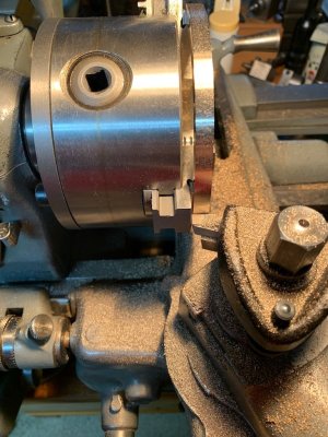

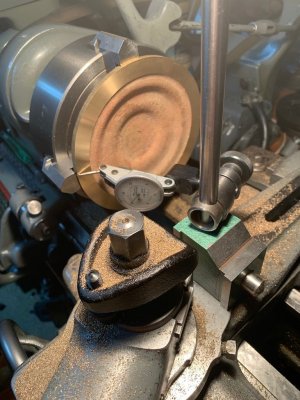

Hi All,
Further work on the blast pipe assembly.
To turn the OD of the lower blast pipe body, the simple threaded holding fixture was produced as seen in photo 224. I could have used the 3 jaw chuck for this operation but I chose to set everything up and dial in the work on the 4 jaw chuck if ever I need to use this fixture again in the future (and I likely will). It was made so that everything would run dead concentric and parallel (thickness wise) with the internal thread of the lower body.
Both the internal and the external thread on the blast pipe itself and on the lower body thread needed to be modified slightly to do what I wanted which was to mechanically seal the threaded ends of the two parts together to form a continuous internal taper as per the design drawings. It is easy to draw it this way but not always so easy to reproduce. This was necessary as one cannot thread right up against a square shoulder (as seen in photo 223) when using a threading die due to the lead in on the die. Also, I could not cut the usual relief at the end of the thread on the blast pipe itself to allow for this as this would leave a weak wall at the recess. The blast pipe is torqued into the top of the cylinder exhaust and I will not risk snapping it off when tightening it in being bronze.
So as an alternative, the first couple of external threads at the end of the blast pipe were turned off and as well the first couple of internal threads of the lower body were bored away to create the necessary clearance to allow the parts to bottom out (photo 225). A small but necessary detail.
