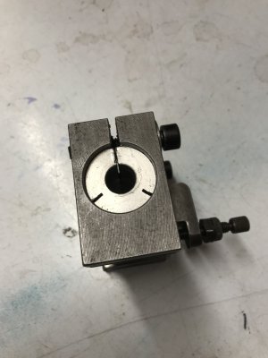

Here is the boring bar holder on the right. It accepts 40mm tools. On the right in an ER40 collet chuck with 1" shank. In the middle is the split bushing. 40mm OD: 1"ID.
The reason I wanted more photos was to understand how the part bends under load.
On looking at your picture, one side is cut right through and the other side is cut lengthwise about halfway through. So virtually all the unconstrained bending will take place in the remaining section of the half slice. Of course when constrained it will bend in the entire cylinder.
My own preference would be to drill and tap through the cross-section of the full gap and use a grub screw to pry the halves apart enough to get whatever you want into the bushing. Think like expanding a threading die for a bigger thread. Then remove the screws for the actual machining period. They are only there to pry the halves apart enough to insert or remove a tool.
As I said before, the other way to do it is to deliberately yield the half sliced section. It could be done with a small expander or perhaps even your shotgun tube mandrel. It shouldn't be too hard to do and would not affect the function one iota. If it is too hard to do, then the section is too thick anyway. Yielding the section once won't hurt it given the way it works. Especially if you are careful about how much you yield the section. Just enough to get a tool in and no more.
Another possibility is to slice through the bushing in a few more places. Enough so it stays together for convenient use but not so much as to constrain it for tool insertion. I think you could safely complete about 75% and perhaps much more of the length of that cut. Even keeping it intact at just one end would be better than leaving the entire half slit as is. But I'd try leaving a half inch at each end and just cut the center out. This should make it about 5x easier to insert a tool.
Although I'm not keen on the idea, you could also cut it right through from end to end and then use sliding pins and/or slip screws to keep the assembly together. Again, I'm not keen on this one but throw it out there in case it spawns a better idea.

Well, sorry boys, I got fed up. I tried to expand the new split bushing using my shotgun barrel dent raiser and several sections of 3/4" type L copper tubbing. It would expand the bushing, but as soon as I released the pressure it went back to where it was. I reached the limit of the raiser. So I said @#$#%, I have exceeded my allotment of time devoted to this, so I chopped off a section of the bushing, expanded that section, held the slit open with some spacers, put the collet chuck in, and removed the spacers. Now the outside diameter is exactly 40mm, and the bore of the bushing is still 1.000". Now that tool is dedicated for that holder. It is what it is. I've learned a valuable lesson and hopefully I will remember it, which is getting more difficult with time!!
