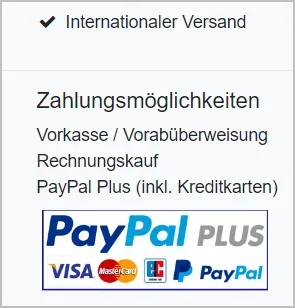

So now that your beautiful parts have arrived, can you tell us more about the particular vendor in Germany you used & why. I'm not after price, that's your business. Just wondering if they are a designated distributer for this line, or maybe the manufacturer? What other goodies they offer, if it was less cost vs (if it even exists) via N-Am sellers etc. Lastly, how was payment made? I've tried to order a few things from Germany, maybe it was bad luck with the particular vendors I was attempting to dealing with. But they had some very weird (what I would say almost regressive) payment modes unlike common e-payment methods we are more familiar with.

I was going to go for the Create Tools version after seeing many Youtube videos and comments on the net. But when I tried to get a hold of them, no response. Apparently the owner died. The Klopfer unit sold by KAR Industrial was literally a fortune. So I decided to go with the AXA, and ordered through stahlhalter24.de. I just picked what I wanted, put it into my cart. When the site asked for destination, it had Canada (Kanada) listed. So it immediately removed the VAT tax, and added the shipping costs. Paid by PayPal. I had a confirmation response right away. The following day another email from them advising of expected shipping time. In less than a week the package was sent by DHL. It took several weeks for the packages to arrive. I received an email from them saying that they would split the order into two orders and shipped a week apart so that it incurred less paper work and permits. Over a certain value they have to apply for export permits. Easy peasy! The company I ordered from only sells the AXA Multifix. The other company, top-machinen sells everything!

Saw this on the website, Woot-Woot!
Things are going to get interesting in the next year, but I digress...
