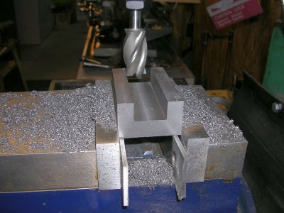

This is where I screwed up last time. I need to open that slot up 3/16" or less. Enough for today.

Now what to do????
This is so close to the tolerance I was hoping for that I'm afraid to put it in the mill for one more pass.
Brent H
Craig- do not put it in the mill - put some 1000 grit on a straight edge or similar and just clean it up - break edges etc and check fits
Actually check the channel for squareness too. Cast iron shouldn't stress relieve much if any (as in the lips came in a couple thou). But kind of depends on the material, heat aging, material removal profile etc.

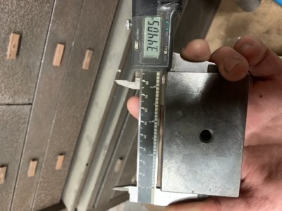

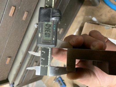

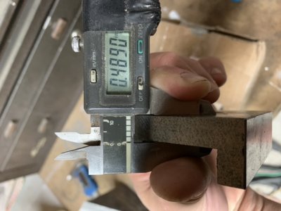

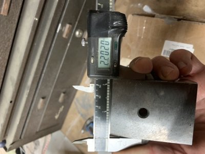

Some dimensions- just with the verniers
looks like 1.5 thou clearance on the bar - no movement so may be a bit tighter than that - slides nice.
Brent H
Hahaha!!
about the same.
the bar was pretty rusty when I got it so perhaps some wastage. What width are you looking at?

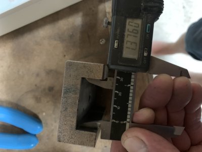

My bar appears to be 1.186" wide by 0.693" high. I'm starting to think I don't know how to measure things properly. Neither of those values makes sense even in metric?
RobinHood
IIRC, the bar was ground. So if they cast the slider block and machine the U-shape to 1 3/16”(1.1875) and take nominal cold rolled 1 3/16” bar (which would measure a bit oversize) and surface grind the bar, they could end up with a bar width of 1.186” for a nice sliding fit in the block.
Brent H

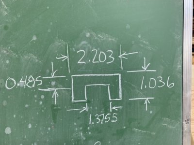

There will be some clearance needed once the block is bolted to the cross slide extension- the slot in the block has the side grooves for oil/gunk.

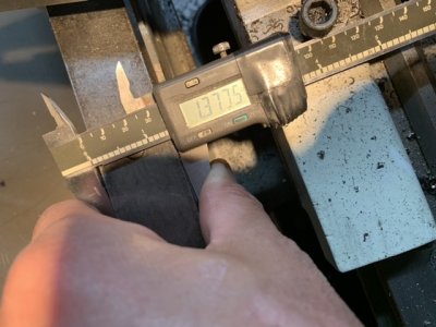

my bar measures 1.374 x 12.000 and 0.694 thick
here are the block dimensions:

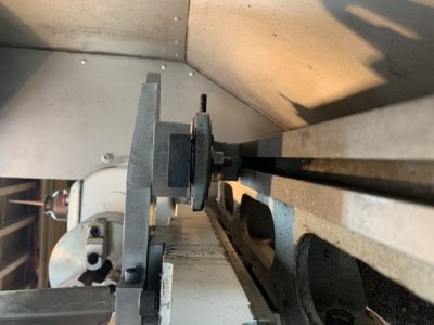

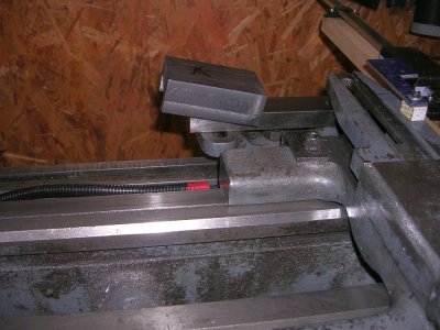

It is a snug fit under the cross slide extension:

Hi Craig, following your thread with lots of interest nice work however, somewhere along the way I missed out on what your project is.
From your latest photos I assume you're making a taper turning attachment for you lathe so you can reproduce tapers?
