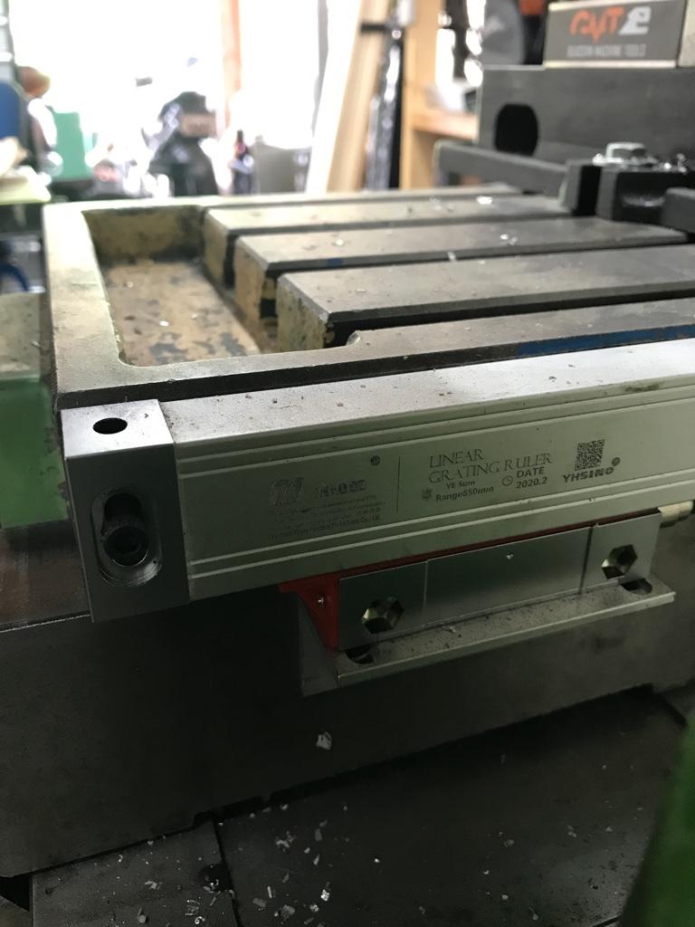

Well...…. your experience is a little different than mine when it comes to cutting glass scales. When I cut my scale on the bandsaw the glass shattered a good 1.5" back from where the cut was made:mad:. I'm going to have to fill behind the end cap to keep the reader from running off the end of the fractured glass part. It still appears to work ok, just a little less reader reach than I had anticipated.
You have to look hard for the fragments but you can see how the glass scale shattered rather than cut clean.
Argh! I’m sorry that happened.

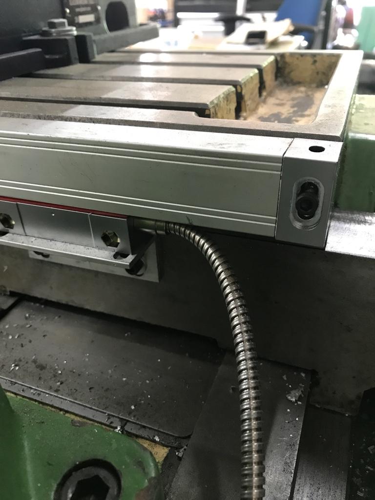

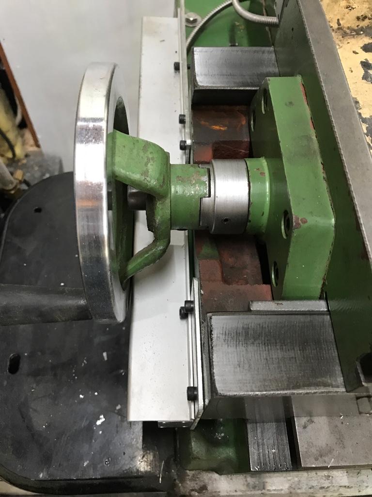

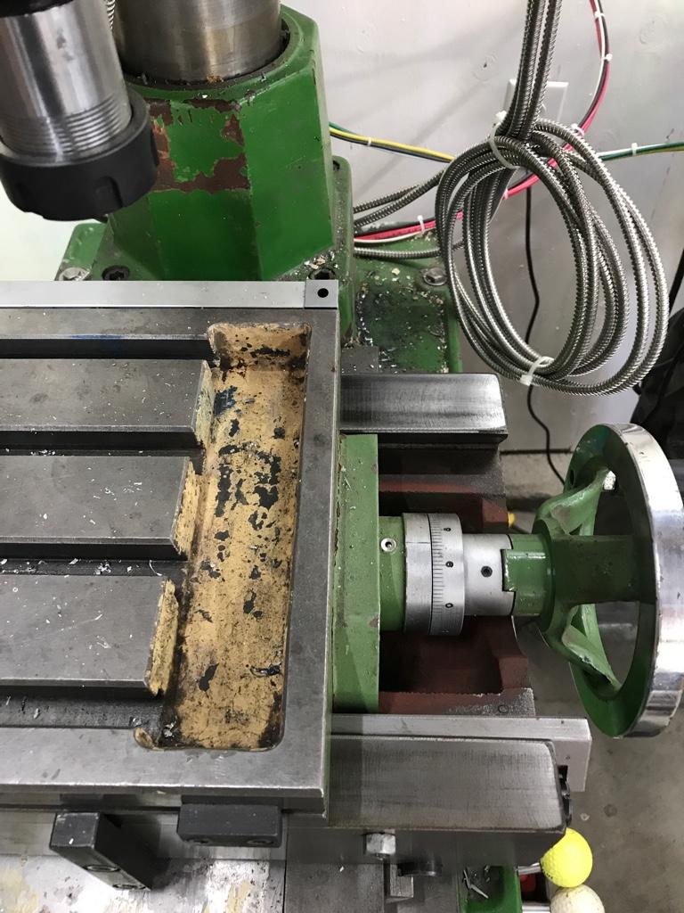

If the scale goes across the full width of the table there is 2.5” of table at each end that is not usable because there are no T-slots.
The is the reader head relative to the end of the scale with the table extended as far as it can go in this direction.
This is the table cranked almost to the end of the range the other direction. At this point the spindle is no longer over the T-slots.
This is the position of the reader head at this end of the range.
@David_R8 how did you mount your scale in the bandsaw? I'm wondering now if I didn't set myself up for a fail by how I mounted it in the saw. I mounted it reader up.
I mounted it with the glass horizontal.
My thinking was that maybe the blade would score the glass enough so that it would just snap off.
The best way would have been to cut the enclosure, then nick the scale with a file and snap it off by hand.
Well...….. now we know how not to do it:(
