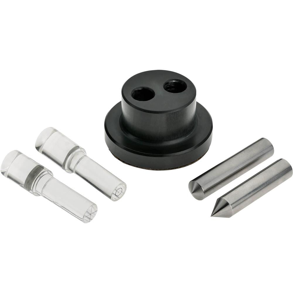

Could you machine a 8mm sleave for a transfer punch to go in like those centering units that use magnification to find scribed lines?

Like this:
Like this:
Very Cool. Never knew this existed. Thank you Craig!
How the heck do you see down in there? Does shining a side light on it somehow get funnelled down the hole to the work?
Keith Rucker on the Vintage Machinery Youtube channel goes over an optical center punch in the following video:
Thanks for that idea and the link. Did you buy one of these? I tried but I noticed that the only shipping option is UPS Standard which in my experience incurs a $50+ 'handling charge'. Buyer beware- the same Grizzly set ($47USD at Grizzly) is listed on amazon.ca for $141 CAD! Forgetaboutit! :) Unfortunately the Veritas (LeeValley) version is discontinued. LV is on a downhill slide. I tried looking on AliExpress - assuming the Grizzly tool must come from China, like all their stuff - but couldn't find one. Perhaps I didn't hit the right search terms.
I don't own an optical punch; just remembered it from the Youtube video and found a random link via DuckDuckGo.
I wouldn't turn one down but with a DRO it probably has limited application, IMHO.
