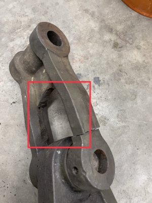

I agree that this looks to have had a previous issue and an initial crack.
I have another approach you may want to try. One I'd want to preserve the part as clean as possible so I'd not want to try brazing or welding as a first option.
Your project has a certain cool factor that will interest people. Your project deserves as good a "rejuvenation" as you can provide it. That means using a cast iron piece rather than aluminum if at all possible.

It was definitely cracked before. I'd be tempted to make a new one from steel. What are the dimensions?
had to tell from the perspectives the photos were taken while Kevin was holding them, but I got the impression that the web that had previously cracked was about 1/2"
The upper end of the member cross section about 1 3/4" x 3" and the lower end maybe 1 1/2" x 3", we know the pin penetrated the one end.. overall maybe 13" long? Lets see how close I am when kevin replies
If you are going to stick the pieces back together, it is advisable to try tig or stick weld (NI ROD 99% is my preference) first as brazing makes it impossible to do either afterwards as brass/bronze doesn't play well with any type of arcweld. Speaking from experience.

Kevin, yes it broke while you were getting the pin out, but it was already missing a large junk of the web (red box) and the ear was cracked part way through (as shown by the discolouration).
I would make one from steel. Or get one cast from CI (that could get expensive).
I don’t think aluminum will be strong enough.

Alternatively, a pin could be made to go from one arm to another and welded/brazed in.
Fabricating a piece out of steel is probably the sure bet, and the easiest to do.
Hey Kevin, I never did vote. Just said it wasn't your fault. If this happened to me, (and similar things have), I would make this out of four pieces of steel (two arms, the spindle, and a web) and then have someone who knows how to weld put them all together for me. That's a really beefy looking part and it cracked in use so I'm not in favour of making a casting. I'd vote for a steel replacement.

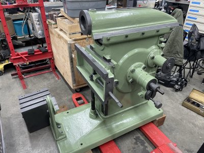

Hey Kevin, looks like you have the correct mix of vodka with the paint! Way to go!
On the part breaking it looks like the first failure point was already established and probably a blessing it broke when you think about safety and the machine running and then having it break! Yikes!!
For a repair I would suggest making it out of steel. If we were closer I would try to weld it for you with the funky nickel mig wire.
Very nice job so far!!
Amen!
For the record, I think there is waaaay too much paint in the vodka.

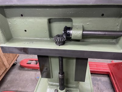

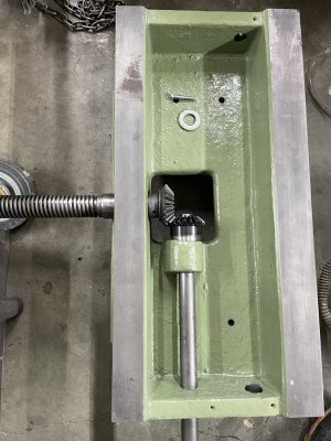

Ok, onto the bevel gears.... decided not to cut the gears for this as I don't have all the correct cutters (I will cut them once I get the cutters, but spring is coming!)

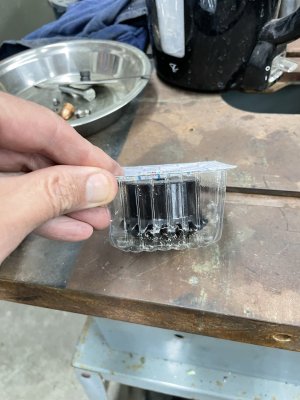

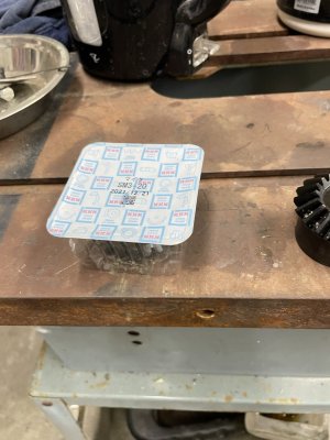

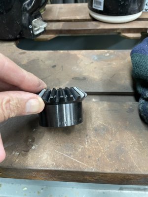

I decided to try ordering from KHK gears out of the USA (distributor for the Japanese arm). Short answer, not cheap (about $45 USD / gear + 45 for shipping. But, great service, great communication, fast response time -- I would definitely order again. The packing is impressive. Each gear came sealed in it's own package, blackened finish, 100% to spec. The offer Canada Post shipping (risky, but was nice as I was on vacation for 2 weeks). They emailed to say that UPS was the same price.... I said I doubt it once they deliver it, hold me hostage on the duty/customs and pretend that they can't deliver to my acreage. Canada Post please. No problems.
The nice part is that they provide CAD drawings for all the parts so I was able to print models to dry fit etc.

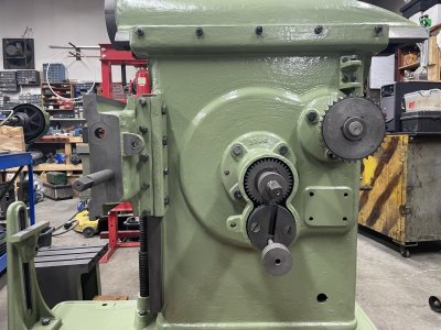

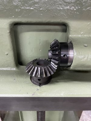

After receiving, I decided to use on of the original cast-iron gears w/new gear. I had to enlarge the bore from 16mm to 19mm, and had to take about about 0.100 on the base to ensure a smooth fit on the casting.
Mounted and meshed!

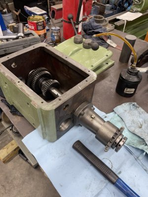

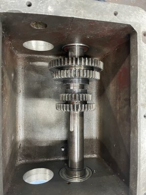

As a side note, the original shaper did not have a thrust bearing below the knee/apron... I added a 14mm thick bearing to make this more 'bearable'.
This required drilling new holes for the pin, and I opted for roll-pins vs. tapered pins as I'm not good at the taper pin reaming (yet).

For the already broken web - what happened there? Fatigue? Damage? Any thoughts ?
