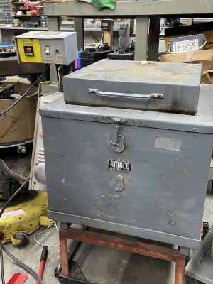

I dusted off the kiln (thx @Johnwa ) which will be used to heat treat these prawls. Overkill (I could do a lot of them) but good excuse to convince the better half that I need a kiln. I use a simple PID w/SSR to manage temperature. For tempering I'll either use a toaster oven (thx @Janger ) or my other kiln (preheated and ready)
I fired it to 800C the other night -- ready to go this weekend.

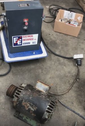

The motor on the shaper was 'free' and the pulley turned, but the bearings will likely need to be replaced. There is no motor plate, but the plug was wired for 220V 3ph. A manufacturers tag plate is there, but it is all but not-readable except for Odense Denmark. I took the electrical cover off, it was packed with crud and rust. so I cleaned that out.
I pulled the end covers off, wiped off the spider webs, blew out the dead bugs and dirt, then degreased everything (using Paslode corldess nailer degreaser -- i'm a fan now). I didn't see anything wrong so put it back together, greased the bearings and fired it up with a 7.5HP RPC (thx @RobinHood )
A little loud.... but she runs. Let is run for 45 minutes, motor is cool (neigh - cold) to the touch.

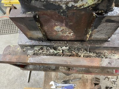

ok, a month later...... still working it daily. Shaper is completely torn down, no more assemblies to remove.
It's been a non-stop process of remove, degrease, de-rust, repeat.

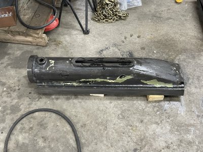

Ram after de-rusting

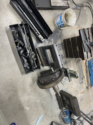

Apron removed

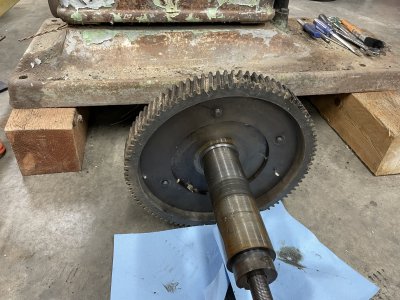

Bull gear removed

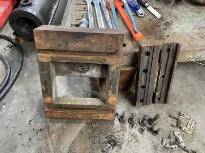

Apron disassembled

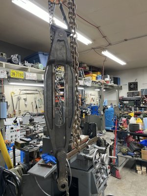

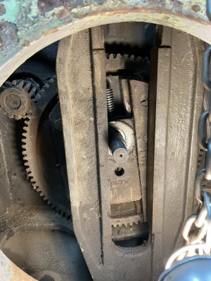

Yoke/bull-gear BEFORE removal
Yoke after about 4 hours of figuring out how to get it out of there

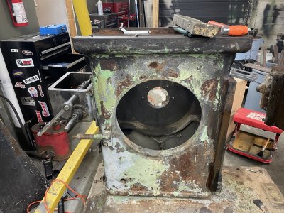

Just a shell of its former self

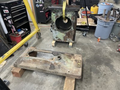

Separating the base from the cage

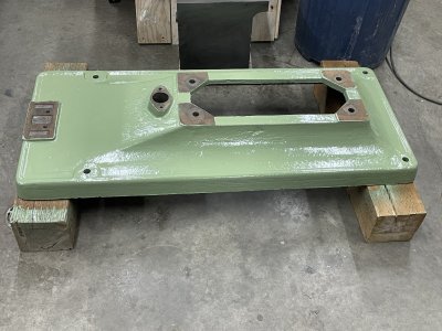

After some back and forth with @Brent H about HVLP painting, a first look at the chosen color. Yeah, I'm a sucker for 'russian-implement-green' as I call it.

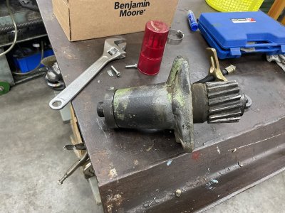

Main drive gear. Believe it or not, no ball bearings. All bronze bushing
A peak at some of the drive train after de-rusting/cleanup.

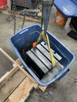

de-rusting the table. Not enough product to immerse it, so painfully slow '6-sided-dice' approach
Switched to tupperware bin for wide-sides. You can see the results on the side facing up in this pic.

What's the grey machine behind the yoke with all the dials and hand wheels?
I think your yoke is just a tad larger than mine LOL....

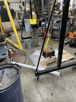

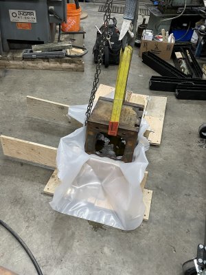

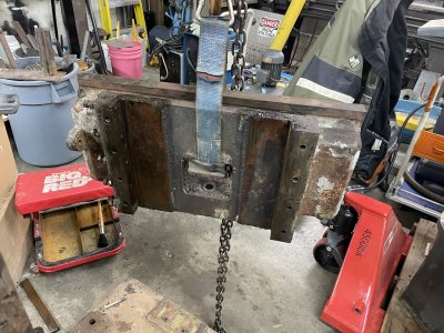

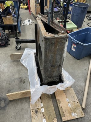

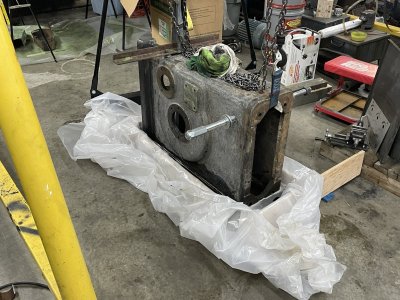

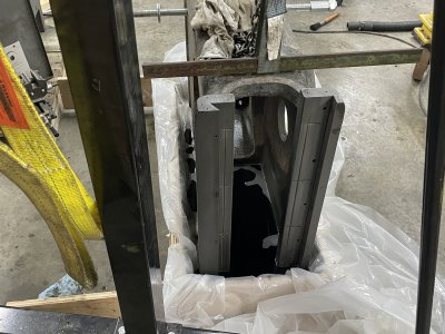

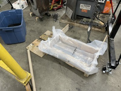

So the main casting is one piece and includes the top V-ways as well as the ways for the main apron. Both are heavily rusted. I figure the casting is 600-800 pounds. Even a 55 gallon drum of product won't immerse this bad-boy, so I continued to use my resizeable soaking coffin assembly.
Step 1, invert the casting and dip the v-ways.
Step 2, rotate 90-degrees and soak the front ways. The threaded rod I'm using to lift this is a multi-purpose tool, last seen pulling the pistons out of my ford tractor.
So is it working? You tell me, a pic of the v-ways from the back side while soaking the front-ways
Looking pretty good.
