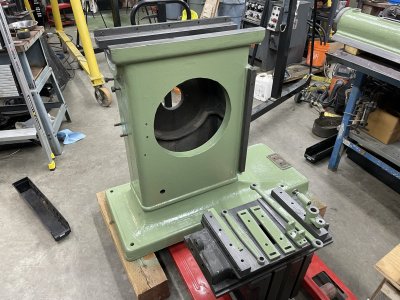

Mystery Shaper rejuvenation
And more!

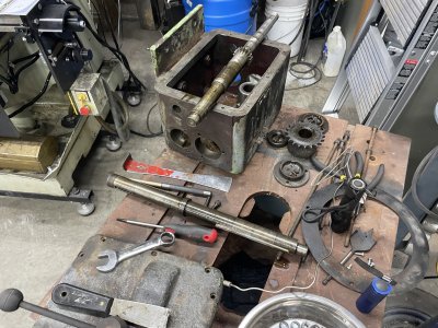

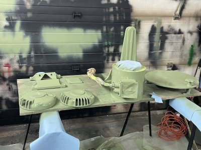

Transmission disassembled. The shaft that is sitting on top of the casting is crazy. It has 7 different diameters, is threaded in 3 places and has the gears cut into it..... Needless to say it only goes in one way

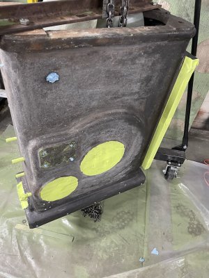

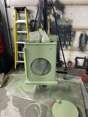

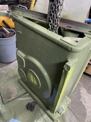

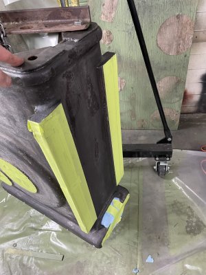

Prepping for paint
I'm a disciple of the @Brent H school of painting. To boil it down............ put a 2mm needle in 'er and give 'er hell!
I should mention, I'm not a fanatic on finish.... no bondo/filler on this unit.

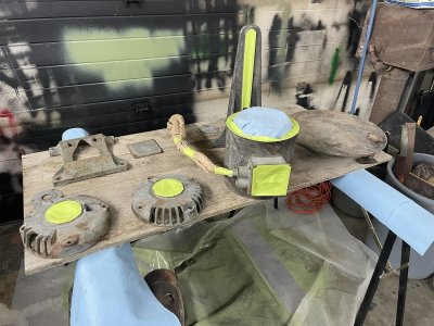

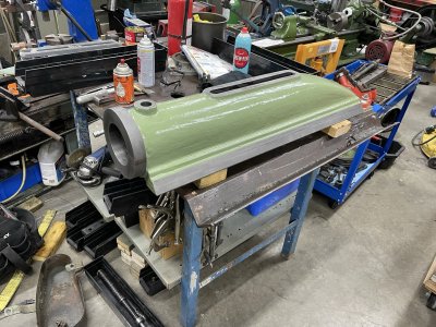

The ram silently waiting its turn on the paint bench

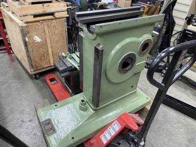

That Sir is one awesome rejuvenation. It is great that you can save this from the scrap heap of time.

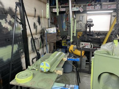

Nice job Kevin!! The Russian ghetto Graffiti gang would be proud!!! Looks like you got the correct blend of paint/vodka - excellent!!!
Your Andy Warhol on the back wall is fantastic!! Things are “shaping” up ;)

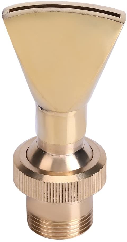

I can't find the ones I ordered from amazon years ago that had the fan shaped nozzle but this is similar.
Those with a 3D printer can print any shape nozzle they want though. Or just search more on amazon and they should have something good. Just be mindful you dont want tons of flow or head pressure... you want a river of solution not a geyser

Wondering about the fan nozzle. Is that like a flat spray?
yes
It looked like this but was injection moulded plastic. It spreads the flow across a wider surface pretty well and when it comes with the pump it's a bonus
I couldn't find anything like that made from plastic but I did find one quite similar on Amazon for $22. Too steep for the purpose. But I think I could probably make that out of brass or copper pipe pressed over a piece of flat stock acting as a mandrel in my shop press. I don't need the fancy spray pattern - just a nice bath.

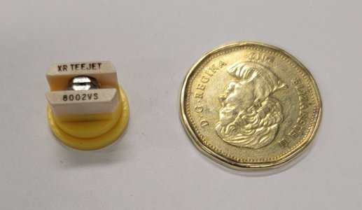

Hmmmmm....... Here is a photo of one with a looney beside it....
Be a great test of my new micro drill chuck if that would actually work......
