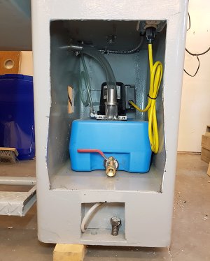

I've added a coolant pump. Busy Bee had a 220V coolant pump and reservoir on sale about 2 years ago - I think it was significantly less than $200.
https://www.busybeetools.com/products/coolant-pump-for-metal-working-mach-csa-b3087.html
They call it a 5 gallon reservoir, but that is only true in some other reality. Realistically, it can hold maybe 8 liters of coolant. The tank is a double reservoir design, so filings and metal bits can settle in the first tank, then the coolant overflows to the second tank where the pump picks it up without recycling too much junk.
I wanted to run mine on 120V instead of the 220V it is listed at, since it fit my wiring plan better. I did some web research and this pump is made (or imported) by Flair America (flairamerica.net). It seems to be one of the MC-81xx pumps which are available in 120V and 220V models.
I took the BB pump apart to see how the motor is wired. It is a simple 1/8 HP induction motor. The field coils are two identical 120V coils wired in series to operate at 240V. That is what I had expected since they probably really only make one motor with slightly different wiring for 120 or 240V. I changed the wiring to put the field coils in in parallel for 120V operation. I was careful to keep the phasing the same, and now it is 120V motor. So, problem solved. I added a cord with a regular plug on it. It doesn't look like I took any pictures of that operation, so you have to trust me.
I used some scrap aluminum (from an old computer monitor bracket) to make a bracket to hold the drain tube from the chip tray in the correct spot. You are looking at a couple of my first non-practice aluminum TIG welds here. I had to machine out the hole in the bracket to be a bit larger to hold the tubing, so there is some machining content here.
It would make a real mess if the return tube (from the bottom of the chip pan) decided to come out of the filter basket, so this bracket will ensure that it will stay put. I then added a drain and a valve to the bottom of the reservoir so it is easier to change the fluid in the future. Without the drain, you'd have to hold it upside down while it made a mess draining out from the big hole. It seems I can never leave well enough alone!

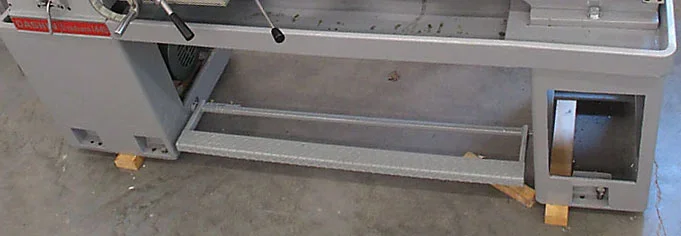

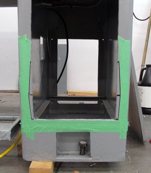

When I was re-assembling the main lathe pieces a while ago, I cut an opening in the right hand side pedestal so I could easily get in there from the front. Of course, the hole was not quite large enough for this reservoir, so I had to make the opening a bit wider. Also here you can see the angle iron I added to make a base inside the pedestal. 15 minutes with a metal cutting blade in a saws-all with a few daubs of paint, and the opening looked like I had intended on doing that in the first place. No one (except the whole Internet) will ever know.
I installed the rear cover and a piece of painted MDF on the bottom (you can see that on the RHS of the image), and sealed it up with silicone so if some coolant leaks, it will come out the front instead of all the places where it is almost impossible to clean up.
Here is the completed pedestal with the coolant pump installed. There is a plug installed on the top of the pedestal where the coolant pump plugs in. That plug is switched with a switch on the front control panel of the machine (more on that soon). The only thing left to do here is make a cover and attach it with a few magnets. The little hose on the bottom drains anything that might spill or leak in the pedestal, so I will hopefully notice it before it makes too big of a mess when the cover is installed.

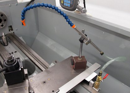

Up top, I added some plumbing that connects up to the vinyl tube that runs up with the DRO wiring (see a previous post). I used a simple air fitting attached to the carriage (hopefully that will work OK with water based coolant). I then used an old magnetic dial gauge stand I had hanging around and made bracket to hold a piece of tubing and connected up a valve to control flow and a nozzle that can be moved around to direct the coolant wherever I need it.
Nice job John. My bandsaw has a very similar coolant pump and tank. Emptying it is a big pain and a mess. The drain is a good idea. Would you mind posting a couple close ups of the drain details? How do you keep it from leaking where it joins the tank?
My lathe also has the coolant coming up there beside the cross slide. I find the compound tends to back into it when trying to cut a taper. So I ended use removing the coolant wand and wondered what to do about that. I like your reuse of the mag base.

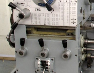

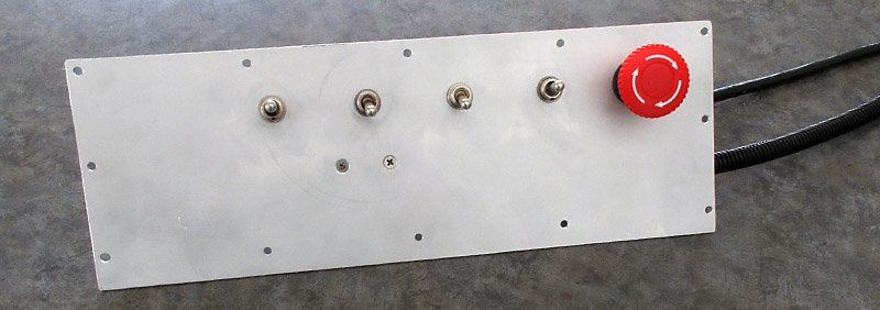

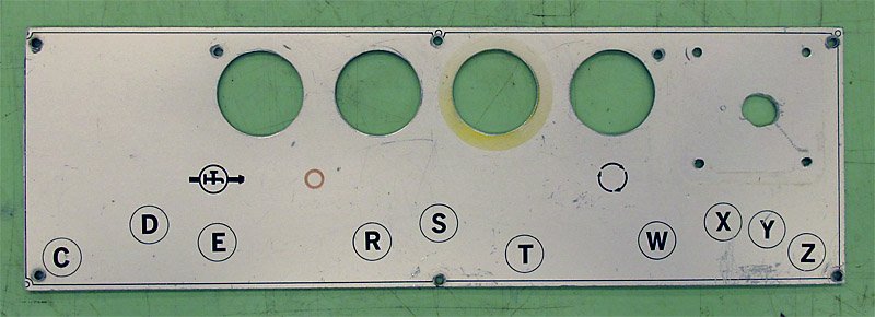

The next sub-project was making up a new front control panel for the machine. Here is what the original panel looked like. It had a couple of large switches, and the previous owner had moved the main power switch, which was originally awkwardly on the back of the machine to the front. Those are the holes over on the right hand side. The letters on the bottom are the labels for the feed gearbox levers.

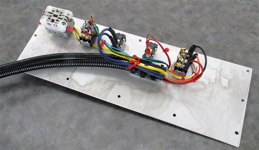

Part of my plan is to use a VFD to power the motor and completely re-design the control wiring for the lathe so I needed to make a new control panel. Here is the new aluminum panel with the new switches installed. The aluminum is from an old sign.
The front:
And, the rear with the wiring installed. There is a bracket in the middle as a stress relief for the wires. The harness is tie-wrapped to the bracket so the wires are held solidly. You can see the countersunk screws that hold the bracket in the previous image. There are both 24V and 120V wiring here. The 24V circuits all go through the smaller shielded black wire, and the 120V wires are in the split loom. All 120V wiring has heat-shrink over the switch terminals so very little is exposed. When installed, the wire harness makes a loop, so there is room to remove the panel and pull it six inches or so away from the machine in case I ever need to get in there.
Here is where the control panel will be mounted. It is not in this picture, but I added a strip of 1/2" x 1/2" x 1/8" aluminum angle iron across the top of the opening to support the new control panel. The old one had no support there and moved a bit when pressing the buttons.
I have documented all of my wiring diagrams, and I will be posting them soon when I describe how I have the VFD and controls set up in more detail.
Edit: added the last picture.

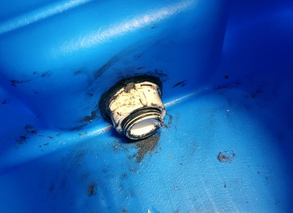

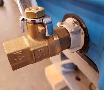

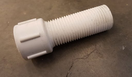

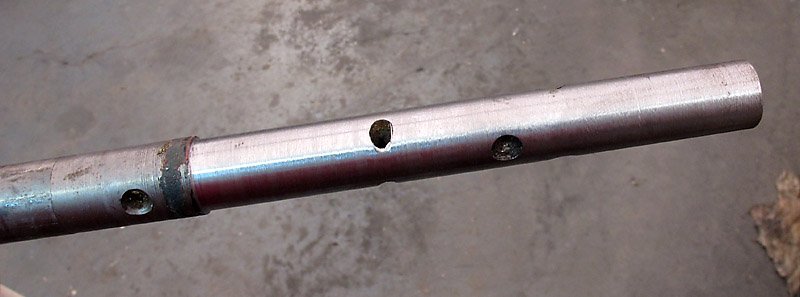

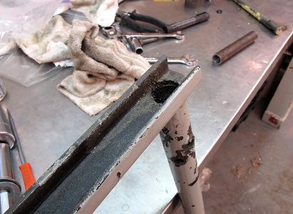

Well, hopefully it won't actually leak. I haven't added coolant yet. Here is what I did. Its been a while and I didn't take pictures. I just ran out to the shop and grabbed these pictures. Hopefully they will tell the story well enough. I'm pretty sure it will work OK.
I found this fitting in the plumbing dept at Home Depot. I'm not sure what it is really for. I think it came with a big nut and a rubber washer, so I bought two (I think this is the left over one). It was only a couple of bucks. From the pictures (I don't really remember), it looks like I cut off the large end and only used the treaded parts and the plastic nuts with rubber washers.
I drilled the hole in the tank and roughed up the plastic a bit near the hole and then installed the fitting, rubber washers (one on each side) and plastic nuts and used lots of automotive RTV on all surfaces. I used some acetone to make sure there was no oil or grease. the acetone likely helped rough up the surface of the plastic as well. I tried to get the fitting as low as I could without risking leaking at the bottom. I will likely have to tilt it forward to get the last of the lube out, but I think it will be OK.
Here is a close up of the outside:
And here is what is inside. Its nice to be able to just stick the cell phone camera in there to get a shot.
The plan is to bring the tank half way out of the pedestal (like I did to get these images), let the valve overhang a drain tray, tilt it forward and be able to remove most of the liquid. Then wipe out most of the filings with a rag and re-fill. A good plan, but only time will tell if it works.
I wasn't sure if the coolant nozzle might be in the way for some project, so I used the air quick connect and the magnetic mount so it can be removed quickly, and moved where it won't be in the way. I have a taper attachment that bolts on to the end of the cross-slide, but I'm only going to install it when / if I ever need it. The coolant plumbing should not interfere with it.
Where the coolant line comes out of the base there is another valve and a T fitting so I can easily install other coolant plumbing in the future if I want to.

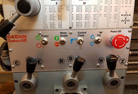

So today is really catch-up day in this saga. I dug out and edited photos last night, and took a couple more this morning, so I'm ready to go with another update:

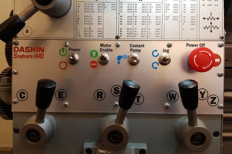

The control panel obviously needs some nice labels. I created the following design in Adobe Illustrator. It is carefully sized to match the new control panel.
contropanel_aigraphics-jpg.2912
I used some acrylic sign making material (https://www.trotec-materials.com/laser-materials/plastic/trolase-reverse.html) and one of the laser cutters at Protospace to make the front of the control panel.
The panel is made out of 1/16" clear acrylic that is painted on one side with paint that provides a brushed aluminum look when looking through the acrylic, and is black on the back. You then use the laser to cut out the panel, and all the required holes, then engrave all the marking you want on the panel. The engraving burns off the paint on the back side and leaves the acrylic sort of a frosted clear where it is engraved. Then using some acrylic paints (I have easy access to that as my wife owns an art supply store), you paint the clear sections from the rear. The rear painting does not have to be accurate in any way since the paint will only be visible where the rear coating has been burnt away.
It easier to show with pictures. We start with the above graphic burn it in reverse on the back side of the acrylic, and cut the appropriate holes. It took the laser cutter about 5 minutes to do this.
controlpanel_5385-jpg.2913
Then grab some acrylic paints from my wife's studio and use a small brush and rear-paint it. No skill required:
controlpanel_5389-jpg.2914
Once it dries, the front looks like this:
controlpanel_5393-jpg.2915
And a close up:
controlpanel_5395-jpg.2916
I think it looks great. It is acrylic though, so it is not as durable as a screen printed piece of aluminum. But, since all the paint and graphics are on the rear scratches will not affect the text or colors, and would have to be very deep to really cause a problem.
I used more mounting screws than the original panel had, and put nylon washers under each screw to reduce the chance of the acrylic getting stressed and cracking.
Once I installed it, here is what the new control panel looks like:

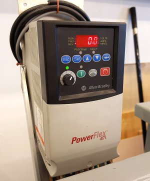

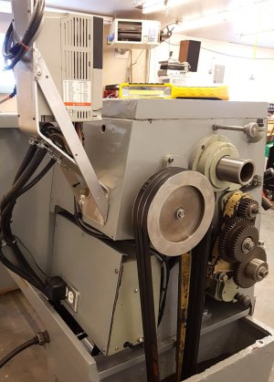

I obtained an Allen-Bradley PowerFlex VFD used from e-Bay waaaay back when I started this project, and it has always been the plan to use it to drive the 5HP 3-phase motor on this lathe. As with most home shops, my shop power supply is single phase.
This is my installed VFD. The label says PowerFlex "40", but it is a "4", not a "40". I'm not complaining, having the wrong cover plate was the only bad thing about that e-bay purchase - I can live with that. The wires coiled on the back are for a future enhancement that I will describe when I do it.
I mounted it behind the headstock where it would stay clear of most chips and splash that might come from the lathe, but still be reasonably easy to reach, and I can easily see the display that can show things like motor drive frequency, rpm, or current draw, etc. The control knob is what I will be using for speed control. It could easily be moved to somewhere else, but I decided not to.
I welded up a stiff bracket to hold the VFD and allow the various wires to be securely fastened and reasonably well protected. The bracket is held by two 3/8" studs that are threaded into the cast iron of the headstock. My aluminum TIG welding is getter better, but not quite show-quality yet.
The metal box under the headstock at the back is the main junction box and contains the control electrics, which I will be posting about soon. Some day I will make side covers for the bracket just under the VFD to better enclose the power wires.
A side note: I had to buy three new belts for the machine as what I got with it had belts that were unevenly worn. When running the motor slowly I could hear the belts squeaking because they were riding at different heights on the pulley. They are installed here and work much better that the originals.

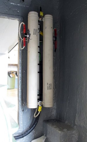

Commercial braking resistors can be expensive, but resistors are simple things, so I made up my own.
My VFD is rated to use braking resistors down to 36 ohms. Using a lower resistance risks blowing up the VFD as the resistors will take too much current. I found a good deal on a few 100 ohm, 225W ceramic resistors. Placing them in parallel provides a 50 ohm load to the VFD which will allow the VFD to dump energy but not so much as to hurt itself.
The resistors are rated to 10x that power for up to 10 seconds, so they can each handle peak loads of 2250 watts for a total of 4500 watts. At that power level they can stop the lathe in only a couple of seconds, so even if I were to cycle the lathe from full forward to full reverse several times in a row, I would not exceed the capabilities of the resistors.
Here is what my home made braking resistor setup looks like:
I got the resistors at a clearance price because they are not ROHS certified (there is lead in the solder on them). Nobody can really use them in commercial products. So, $3 each instead of about $30 each. I'm OK with the lead. They are mounted on two raised studs that are attached to a nylon rod that is then attached to the lathe. Good insulation is important here as there is almost 400V on these puppies. They are mounted far enough above the nylon rod that there should be no problem with heat getting back to the rod and causing problems.

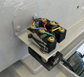

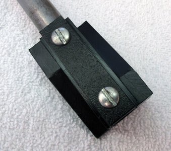

The thermal switches JB-Welded on each side are normally closed thermal switches. They will open at about 130C. The thermal switches are wired in series as part of the enable circuit for the VFD (more on that later), so if the resistors get too hot for some reason, the lathe will shut down until they cool again. JB Weld is good for over 260C constant and 316C for up to 10 minutes, so that should be OK.
The resistors are installed in the left pedestal under the headstock where they are well protected from oil and metal chips and should have good ambient cooling.
Mounting them vertically will give the best cooling since they are hollow and hot air can rise on both the inside and outside of the ceramic.

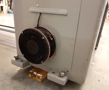

Except there is a problem: The slower the motor goes, the less cooling it gets from its built-in fan because the fan is turning slower (obvious). However, at lower frequencies, it is still making the same amount of heat. So running it say, 20 Hz under load can easily over heat the motor.
My solution:
This is a 24V 1.5A fan that blasts a huge amount of air. I got it out of an old mainframe computer 20 years ago. The VFD has a small relay built into it that can be programmed to do various things. I've programmed it to run this fan whenever there is power applied to the motor. Inside the control box (more on that later) there is a small 20V laptop power supply that runs this fan. The fan still pushes a huge amount of air at 20V.
The bottom line - even when running the motor slow, it should still have lots of cooling.

This post is the first of several about the lathe controls in general. Now that I've built it, I'll describe how all the controls work, and then go into how I implemented it all in further posts. I spent a lot of time designing all this, so it might be useful if someone else is considering doing something silly like completely re-wiring a piece of their equipment.
So first there is the main control panel. I've already posted a similar image, but here it is again for reference:
Power:
  • This is a momentary switch with the center position being off.
  • Pressing it up engages and latches the main power to the lathe.
  • Pressing it down unlatches the main power relay (contactor) and turns the main power off.
  • Turning the power off while it is running will cause it to coast to a stop.
  • When the power is turned off, the VFD takes about 30 seconds for its capacitors to drain to a level where it displays an input under-voltage fault, and then the display finally goes blank after about 10 more seconds.
  • It takes the VFD about 10 seconds to boot itself up when power is turned on. That is one of the reasons for the Motor Enable switch, so the VFD is not continuously cycled, which is not particularly good for it. It is better to cycle it less often.
  • Turning off the power also brakes the enable line to the VFD, so the VFD will instantly stop powering the motor.
  • It is important to use momentary contacts on the main power so if there is there is a power failure that the lathe will not automatically power itself back on when the power comes back on.
  • There is a 120V plug on the back of the machine that provides 120V (limited via an internal 7A breaker) to power external things like the DRO and some extra lighting I will eventually install above the lathe. That plug is live whenever the lathe is powered up.
Motor Enable:
  • A normal on / off switch.
  • The VFD has an enable circuit that has several switches in series. This is one of them.
  • If you set this to disable, it tells the VFD to not run the motor under any circumstances. Other switches in this circuit are the brake resistor over-temp switches, and an extra contact on the main power relay.
  • All of the switches in the enable circuit must be closed in order for Motor Enable to work, so a wiring or switch problem will tend to disable the motor rather than accidently enable it.
  • This is useful when working on setups. Like maybe adjusting a 4-jaw chuck. It is not necessary to turn the whole machine off to safely have the motor disabled.
  • The auxiliary power plug stays on when the motor is disabled so the lights and DRO remain on.
  • Turning this off while the motor is running will cause it to coast to a stop.
Coolant Pump:
  • This one's pretty simple. It simply turns the power on and off to the coolant pump.
  • I probably could have integrated this with the motor or the enable circuit so the coolant would only be on when the motor is on, but I choose to keep it simple for once.
Jog:
  • Another momentary centre off switch.
  • Pressing down gives a forward jog command to the VFD. It runs the VFD at 6Hz with a 0.5sec up and down ramp. It is easy to just rotate the chuck a fraction of a turn with a flick of this switch.
  • It has no affect if the motor is in regular forward or reverse motion as commanded by the F/R lever.
  • Pressing it up actually runs the motor momentarily in reverse. I had planned this to be just like forward jog with different speeds and ramps, but the VFD won't do it without disabling some other stuff that I think is more important (I would need a fancier VFD with three digital inputs instead of just the two mine has).
  • Still, it works OK as reverse jog. A brief flick upwards jogs the lathe backwards without actually going very fast or very far. The lathe is programmed with a 2 second ramp for normal operations, so a 1/4 second flick does not go very far or fast.
Power Off:
  • Not called Emergency Stop since what it really does is turn the power off.
  • Still a good thing if for some reason it is running (or on fire) and does not want to stop.
  • If the lathe is running it will coast to a stop when the power is off.
  • It is much faster to stop the machine using the brake lever across the bottom, and the Motor Enable function is better for doing setups, so this is unlikely to be used much.
Next I'll show the normal direction and brake controls.
On to the Forward / Neutral / Reverse Lever:
I may have posted this image before, but over on the bottom right is the FNR lever. The bottom shaft has a keyway running the length of it. The lever has a key that runs in that keyway to rotate the shaft and then move the shaft on the bottom left of this image in and out. When I rebuilt the machine, the key was very loose from wear, so I made a new one. Sorry, no pictures of that.
I put the bracket that holds the FNR level in the mill and re-machined the slots that are used as the detent. They don't look great in this image, but they were way worse before I cleaned it up. The lever was very easy to knock from the neutral to the forward position because the side of the deeper slot was rounded off. The lever has a roll pin that sticks out and sits in the deepest slot for neutral, and is limited by the wider slot for the forward and reverse directions. I ended up drilling it out and installing a larger diameter roll pin and making the slot wider to be able to machine off the worn part.
When the FNR shaft near the headstock moves in and out, it move this HDPE ramp that I made (see a previous post) past two micro switches on the back of the lathe. What I inherited here looked like a poor repair of something that had been broken in the past. It was not good.
When using the FNR lever there a couple of things to note:
  • If the lever is moved from N to F or R the motor turns on in the correct direction based on the contacts that are made by the micro switch (obvious).
  • Those wires control an interlock relay in the control box that signals a forward or reverse command to the VFD (more on that later).
  • If the motor is turned off for any reason when the lever is in the F or R position, it will not go back on until the lever is returned to the N position and then moved to F or R again. This is the safety interlock.
  • The motor could be turned off because the brake lever was pressed. In that case the interlock relay does not allow the motor to restart until the lever is returned to the neutral position. You don't usually want the motor to restart after pressing the brake even though the lever is still in the F position.
  • The motor could also be turned off because the motor enable switch was switched off. In this case the VFD is programmed to not restart the motor if it is enabled while a forward or reverse command is present. The lever has to be returned to N first. Again, a safety interlock.
  • If the lathe power is turned on with the FNR lever in F or R, both the VFD and the interlock relay will prevent the motor from going on until the lever is returned to the neutral position.
I've attached the FNR switch wiring diagram as a pdf.

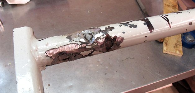

The next thing is the brake lever. This is the manual foot brake that runs along the floor under the bed. This is what it looked like after being repaired, painted and installed. The lever is held by a small stub shaft in a bushing on the right side. The left side has an extension shaft that goes through a bushing through the left pedestal where it actuates a vertical rod that actuates the actual brake.
The problem is that the shaft on the left side is held in the pipe of the lever by a couple of pinch bolts. this was never very strong and it looks like several attempts were made over the years to repair it when it came loose. Stomping on the brake lever with your foot puts a lot of force on this.
The rod with yellow paint on it in the background was quite a loose fit in the pipe and several attempts had been made to make pinch bolts and through bolts to hold it into the pipe. All of the fixes eventually failed. You can see some of the remnants of that work on the lower part of the image.

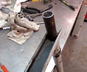

My plan was to drill out the lever a bit to clean it up, then insert the short piece of pipe sitting on the workbench and weld it in place with a bar that could hold larger pinch bolts that would have a half inch of thread to bite into. Here is what I started with:
A little cleaning up of the inside of the lever with a large drill bit, and the short bit of re-enforcing pipe could be hammered into place. I had already run a drill bit through the inside of the pipe to clean it up.
Once it was in, I ground out some of the existing holes so I could securely weld the inserted pipe into place.

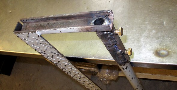

Once the pipe was welded in place, I added a 3/8" thick bar on top, and drilled and tapped it for 3/8" (grade 5) bolts. The bolts now have over 1/2" of thread to bite into (the new pipe, the old pipe, and the bar) so they should be pretty strong and can be tightened without danger of stripping.

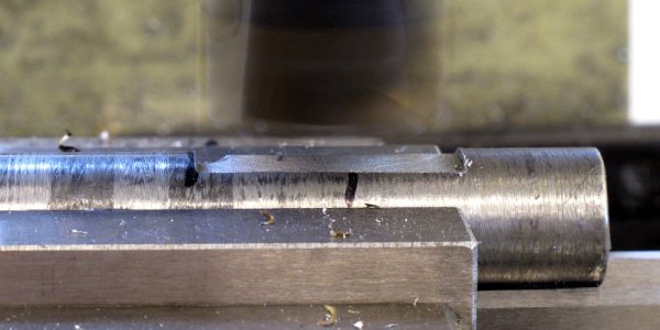

The ID of the inserted pipe is slightly smaller than the shaft, so I machined it down to be a good fit - a few thou clearance. You can see some of the previous attempts to attach this shaft to the brake lever.
To make sure the shaft does not rotate once the bolts are tightened, I machined two flat spots on the shaft for the bolts to clamp down to. Ha-yoo, some real machining pictures!!!
Close-up. Not really beautiful machining, but it is all hidden anyway.
Then I painted it, assembled it, and you can see the finished brake lever in the first image in this post.
