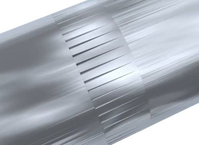

I no longer have any doubt at all. Cut knurling cuts. No ifs ands or buts about it. No halfway, no grey. It cuts just like a lathe tool cuts. It's just that the cutting is in motion.
My advice is to stop fighting it or doubting it. Open your mind to it and ask how not if. If you don't, you will prolly never see it.
Have a real close look at this photo. It might help.
The carriage is not being moved in this photo. It is strictly cut by the cutting edge of the knurler as both the shaft and the knurler rotates around. The cuts are made be the leading edge of the knurler as the rotate around on an angle. This particular one cuts a horizontal knurl. You can also see how the cutter starts shallow then progressively deeper as it rotates through closest approach.
I saw the photo and it shows more than just a cut, if you notice the band where the "cuts" are that would indicate displacement. So....open mind...I still think that there is more involve than a simple cut, I'll keep digging.
I clipped this particular photo from a video back when I was trying to understand how it worked. The slight band is the result of starting in the middle of the bar for calibration. As a result it will rub a bit before it gets going - a bit like a plunge cut. You are not supposed to do that. It should be started at the end with a starting chamfer. You don't get that mark when it is started properly.
Yes I would agree, but look again it on both left and right side. Based on how the cutter works a band on the left only I would agree but where/how does the contact on the right occur when there is no cutter present to make contact with? Again, open mind.....there is more going on and its not as cut and dry. More research is needed.
The same way a lathe cutting tools works, it cuts at the point of contact. You will have seen that this photo is part of aligning the tool, this particular photo is of getting the angle correct. The wheel never cuts along its full width, only the left tip. The wheel must be at an angle (usally 30dg) for this to work.
The operation always starts at the end of the work piece (or a step if knurling in mid of some length). 1mm or so wide, crank in 0.5 of pitch and then feeed slowly axially. With the wheel (and thus tips) at an angle, it cuts as you move along.
