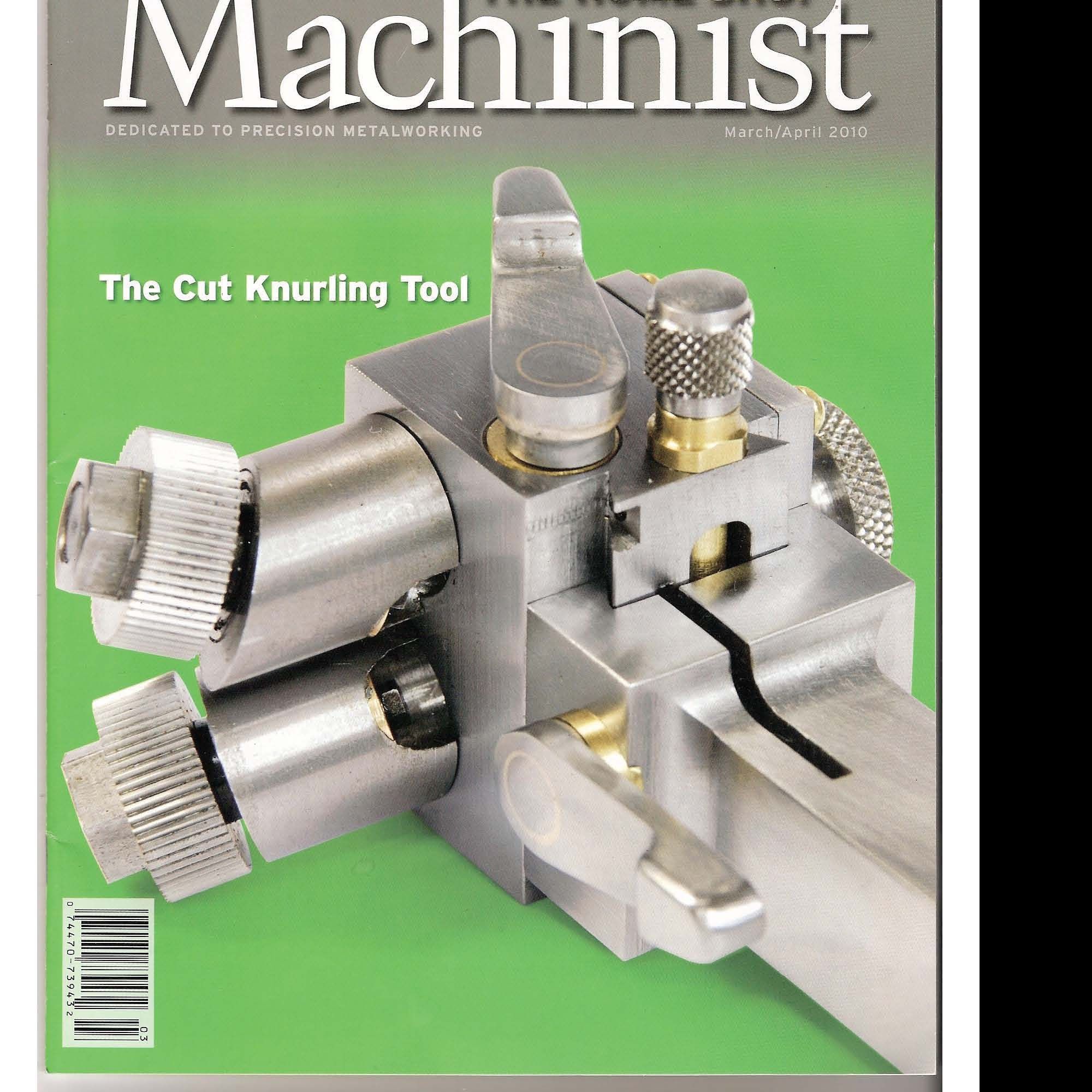

I made one a few years ago but dispensed with the height adjustment since the body was made to fit an AXA toolpost. I adjust height by turning the brass T-knob on top of the body.
@eotrfish and @Mcgyver very nice on both versions.
It looks like you have some kind of cam action but I cant figure out what its adjusting. I guess I'll just have to wait for the drawings release LOL
Do these style knurlers also benefit by having the stock diameter optimized to the wheel pitch like scissor/clamp style. Or is the cutting action different & so you can just give 'er?
There is no cam action. The brass piece with an offset bore is the top cotter which locks the knurl bodies in place after you adjust the angle/spacing.
I felt that the height adjustment was an unnecessary complication so just went with the AXA height adjustment method.
Do you have a drawing and a parts list?
I can dig up the drawings and parts list but you're on your own to dimension the body to fit a BXA tool post:) I also have some extra pinion wire that I used to make the two internal gear shafts - free to anyone that wants to make one of these knurlers.

btw, the off centre hole is not an eccentric. It was just a bit of space saving, making the unit more compact. It got rather crowded up there and this was explained in the article, it saved using a larger dia piece of brass which would make the head longer. As can be seen in my photo above, the piece with the off centre is a double cotter clamping the two rotating knurling spindles.

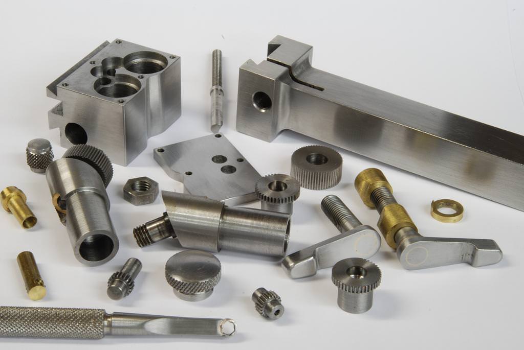

I confess though that I'm even struggling with understanding how the cutters work. I guess it's just not an intuitive process in my mind. I suspect that I'd probably need to actually see it cutting a part.
I do love the end result though - beautiful knurls. So I think it's worth trying to understand what those cutters are doing.
I had to design and make one because I didn't get it either :D
Now THAT is funny! It's amazing how that works sometimes. The things we all take for granted until we actually have to do it ourselves!
Please give me a hint. Does it just cut on the leading corner of the knurling wheels? Sorta like shearing?
Thanks....its a bit complex, but imo necessary to stop it being a complete pain to use as you need to make those adjustments each time you use it. A pic below of the simpler Mk I being used. The complexity came as a result of, sans those two adjustments, and me concluding "what a pita this is to use!". Pay me now or pay later sort of thing lol.
However don't let the complexity turn you away. While a complex project takes more time, there is no single set up, cut or op anyone wouldn't be able to do...and thats all any project is, a series of set ups and cuts.
The innards:

Susquatch, The top roll acts kind of like a rotating tangential tool. The bottom roller is less clear, I think its action is a little different with the cutting face not the flat surface but the V's which notch a triangle out of the helical grooves created by the upper wheel. I use lots of coolant from a spray bottle to clear the chips (so the bearings don't last forever, but they are cheapo router bearings)
