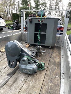

It made it home safe and sound (below picture). Note that the motor had been remove and strapped to the stand. This made the lathe light enough that Stuart and I could man handle it into the trailer (yes it is a small lathe).

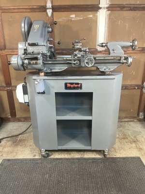

I gave it a thorough cleaning and check over. To my untrained eye, it appears to be in good condition with little measurable wear or any damage from abuse.
Here’s the front and side views:
D5264C02-0C95-47F0-A8DE-2925A9377016.jpegA8950F79-D55D-45F8-8438-58E2238139F4.jpeg1F49456E-AF9F-40BC-B92A-85BAB6A6DABE.jpeg
Yes this (7x19) is a lot smaller than the 10x22 I had arbitrarily set my sights on.
But WOW - double WOW - it has character.
- Made in England.
- Myford has a big following to call on for advice.
- Extremely capable for its compact size / it is punching way over its weight class.
- Parts and accessories are relatively easy to find and don’t need modifications to fit. (Try that with a 52 year old Chinese lathe)
- 14 spindle speeds (32 to 2500 rpm evenly spaced) enabled by an easy to engage back gear.
- No electronics. Just a simple on/off switch.
- Easy to use clutch. Love it!
- QCGB. Nice. Very nice.
- Belt changes are quick, easy and simple.
- It’s not JD green.

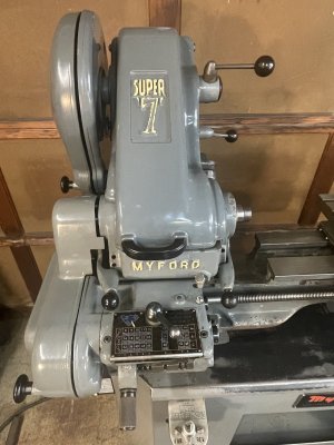

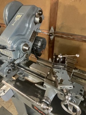

Here’s pics of the QCGB, and the spindle and carriage:

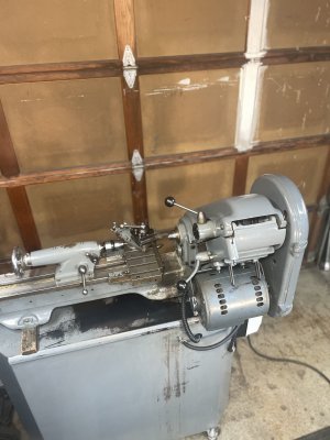

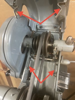

A design thing I like, (in pic below) the clips on the cover engage these spring when the cover is closed. Secure and no rattling!

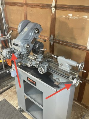

Here’s another design thing i really like (pic below) you can use your left hand on the QCGB lever while your right hand (on the lead screw wheel) can easily rotate the gears to make engagement simple. BTW - this wheel is indexed so that you can accurately control horizontal movement.

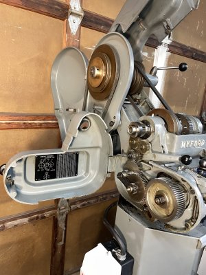

Next pic is the change gears. I don’t have metric gears but they are available - note the decal on the door shows gear selection for metric pitches

why the electrical box on the side with the forward-reverse switch on the front?
I asked the same question:
“Main power” supply switch box on the side is more than an on / off switch. Kinda like an e-stop. Example - If there is a power outage and the lathe switch is in fwd and then the power comes back on. The lathe will not start until the “main power” switch has been reset.
Another welcome to the Myford club! Definitely speak up if there are questions and we’ll try to help. Nice machine & tooling.
Your second switch box sounds like it’s a magnetic switch or similar. You should be able to link the safety circuit into an E-STOP for added safety.

It has a tailstock!!! Woohoo!
It’s not JD green.
Nothing a little paint couldn't fix......
