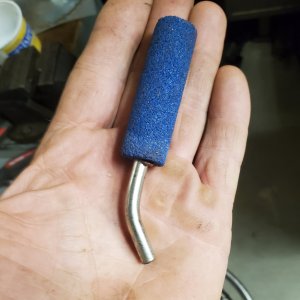

Somewhere I have a long 1/4" brad tip drill bit bent in half. For some reason I thought it was a good idea to mount it in the Bosch Colt on the CNC router and spin it up over 20K RPM. Not being well balanced it immediately decided to bend at right angles just before it went in the collet.
Had it snapped off in my direction I might not be here.

This was supposedly rated for 30,000 rpm, and the die grinder 25,000..... It never touched the work, it vibrated slightly on start up and as soon as it got up to speed the bending began. It was mounted in an electric die grinder with a slide switch at the back of the motor, so not easy to switch off. If I live to be a hundred, that day will always be engrained in my mind as one of few things that took me by surprise in the shop. My wrists still get sore thinking about trying to keep that beast under control.
