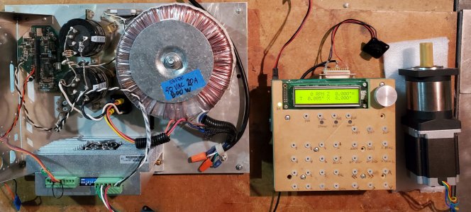

Here's the thing. The photo here is of ELS #1. Used a surface mount processor instead of a 40 pin DIP package which our list members thought would make it easier to update software.
I'm connected to a Bergerda Stepper driver good to 6A and that's connected (set for 3A) to the Size 23 motor I bought through Amazon. Has an 8mm shaft which fits the 25:1 planetary reduction drive I want to use for my power draw bar.
Anyway, I use this one to test things like this. I have another one returned by a customer who toasted the on board stepper drivers by hooking power up backwards. I sent him a replacement under warranty because he told me how he blew it up. That one ran my size 34 stepper motor on the knee of my mill for about 5 years.
What's cool about the test set in the photo is I have the Bergerda set for 1600 steps per rev. That times 25:1 is 40,000 steps per rev. I've set the ELS to think it has a 10 TPI lead screw and a motor driving it with 40,000 steps/rev. Now if I press the >> or << button it moves rather quickly and one full turn shows up on the display as 0.1".
So that's how I test stepper motors and combinations. The only reason I put an ELS on my South Bend Heavy 10L is because it's an imperial machine from 1942. No gears to be able to do metric threading. With the ELS set up for the 1600 step per rev with 2:1 belt drive I have 3200 steps per rev on a 10 TPI lead screw. If set the Metric Operation flag now all dimensions are metric as is motion distances etc. I can set it up to jog with the < or > button any multiple of 0.01mm. And I can do metric threading.

Or I connect the stepper driver to my rotary table and program the < > buttons to move the stepper enough steps to turn exactly 1 degree. Or if I'm doing gear teeth then the distance per tooth. Simple.
At this point in time other than using a PC running CNC software I always use my ELS for mucking with stepper motors or DC servos or AC servos. Great fun. Actually not totally true. I did use a Raspberry Pi4 running LinuxCNC through a MESA 7i92 Ethernet to parallel board to create stepping pulses for a test. So there are other ways.

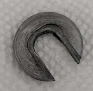

Mucked around in the shop yesterday to make a new clip. Insufficient visualization beforehand. Correcting that now:
So the order of operations: Turn to major diameter, face off. That face gets the wide slot. Mount vertically in vblock in mill. Cut the wide slot. Cut the deeper narrow slot. Return to lathe, parting tool to depth of the inner diameter. Then part off at the total thickness of the clip.
Is the bigger coin on the narrow slot side the one that holds the clip in place inside the sleeve when the bolt is tightened?
If so, is it possible to make it a wee bit thicker for better engagement? If not, could it be done by cutting the sleeve a bit deeper?
I say this for the obvious reason. The old one kept coming out.

Yes, the smaller "coin" needs to be thick enough to register against the small hub (part 1 in the diagram) and not press its shoulder up tight to the spinning gears. I have dimensions scribbled on a page, and if I was better at Fusion I'd model all the parts and check clearances. As is, I'll likely make a couple of them with different depths to try. I don't expect it to be much of a problem.

It took a lot of tries to make this little clip, and by being thighter on its tolerances it seems to work better than the one it replaced:
IUC6P4E9_Nik8fCajEa4YY0FCL5qZjR22QeW9UxJfeSGBMA8MQ96KIZkhoaT8XM89JaHBGWEm80UX6WGlF11vEPxL4_FBajIxnofu_eRVbSh_jnQgUcddWHXZTzXHltjtFLUpR4o_Yq623wDBC7eKHY4BSlyqGQNKymhLkXR2HsnJHFesgXgKePZQnprU2H3nTMJb9QLc6eZAGar2kehMGB-NjGbL4sH1FvQuMrArWm36VK5v5TOYsDvNJlfJbNcrK4JFGLjKIeIoggV8raZbO_bQyS9W9QKCcBR3hC-xbDhVAUCL6TioOKHkkI9Q3H_8vqrvy4Hcim3I5wCczf3zaSoqvCCmB9W1tXpoSKIbskanU_JcU9VQ2-ZqCBJ3f2CWwOOBJO1jhd6oVBjDxLPdvxJ45c9V1rXsqHh4L-zUUWYkOJLXFb_GtoLHEt5uz8sjubt_Z_my-VKAYcX1vozVFpVllZhjwpPH-8iSrj5Dm5IypCi3_qwykJt6lKqTStOCyXEFnJINIUF9XFUdmS0lKf0p-0ZS4nHxqV3rq9d_RNxXrBZKaGk_erAxBtRJ_-_Enaps4H2qT0P8J4yR3RxNmVjswhdvSWd6hyCLkBBCkMDEQ6sSw_b4_5k6Q78ANovDrjVX6PQvfVHjXsaWiVwqa7aD68H3og2zymItj4JDxUBUBb12SY5Vyk1HFC1L4ZaZCYhqQlhLAv-5zm0lKIpfkmPHtT4fP77ij1cR4TofQ4ZHUxxdr0zzB-4JbCn=w1964-h2608-no
I think the improved performance is purely from being a tighter fit between the nut and its fixed shoulder. It's tempting to make one with a retainer across the open gap, though that would be fiddly AF to do.
