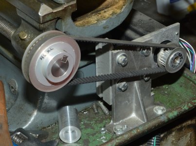

@jcdammeyer , do you offer a complete kit ? I'd love to put an ELS on my emco v13. It has a clutch on the leadscrew that can be left disengaged, so the other feeds via the feedshaft would remain factory.

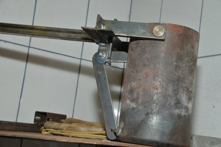

In fact, after TIG welding the bottom onto my pipe crucible he thought he'd just smooth it out on the lathe. Look how smooth the bottom is. And he's in his 70's. He's done some pretty nice stuff with MACH3.

Actually other than creating a keypad template and boxing it up (there are 3D prints for that now too) there is no soldering required on my ELS kit anymore. But you do have to box it yourself. And you have to add a 1 PPR pulse generator to the spindle. Plus power supply etc.
And of course couple something to the lead screw.

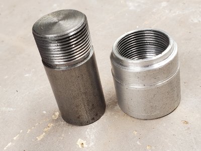

Those are the basics for any controller based system. You can get fancier but it's not needed. And then you can cut 21 TPI threads; if you wanted something that oddball. The male threads look a bit chewed up on this example because I dropped it onto the concrete floor. By dragging by hand the carbide threading tool through and a bit of file work it threading back into the aluminum pretty easily.
