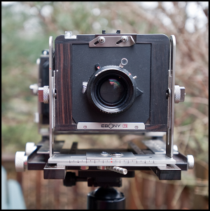

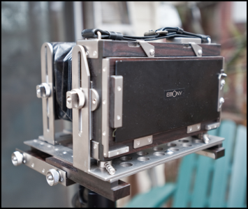

My friend Dave is making mock ups of my view camera design to test with cheap wood before I buy some ebony and other hardwoods to make parts from.
Whoa!! You're gonna make a view camera! Very cool. What size? Did you base your design around a Deardorff? I've shot a bunch of large format product shots and landscape with my Linhoff. Sadly it's now relegated to a living room decoration.
Wow, was not sure you could even get large film anymore. Still got a 4X5, and a 2 3/4 X 3 3/4 I think it is.
