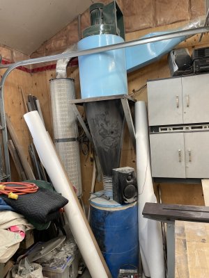

@StevSmar : how crazy do you want to get with your Dust collection? I made mine using a 3HP busy bee and concept plans from the internet:
It was a great project and works extremely well. I have the plans for the cyclone if you are interested.

…how crazy do you want to get with your Dust collection? I made mine using a 3HP busy bee and concept plans from the internet..
That looks great!!! I’ve been thinking about it more seriously since I got complaints from my wife about using linseed oil for finishing wood…
I think I should look at two separate systems:
- dust collection for woodworking tools (just as noisy as woodworking tools….)
- a dedicated ventilation fan to remove smoke from cutting tools and stinky things… Likely just a good quality exhaust fan with ducts to above my workbench, lathe and future(?) mill.
That’s great it works well.
My current top choice for dust collection is the Rikon:
Rikon 1 hp Wall-Mount Dust Collector (Model 60-101)
I don’t think I have room for a cyclone and I’m not using things like a planer or jointer so am not making huge amounts of chips.

Hey Brent,
Is that a garage door guide ?
I guess you can blow the snow off your car with the exhaust air !!

@LenVW : yep that is a door, it has only opened about 20 times in its 15 year life. It is “there” in case a big move is necessary- like when the fork truck parked my mill or when I had cabinets to big to go out the regular door. You couldn’t fit a car in the shop - maybe the nose - LOL. Insulated door and pressed shut by tools pushed up to it and then c-clamped to prevent anyone opening it. It would be sweet if I could use the blower to clear the snow though - winter sucks….(pun intended) LOL
