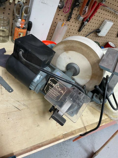

Along with my clamp and ruler fetish, I appear to be developing a grinder fetish… I mean I have two 6” grinders already…
Anyway, I’m looking for an 8” grinder that has dust collection ports and which I’ll also to set up nice grinding rest on (I’ve purchased the eccentric engineering one).
If it’s feasible, I’ll likely use it for sharpening both metalworking tools and for regrinding the primary bevel on woodworking tools. (Regularly dipping woodworking tools in water to cool them down doesn’t seem like a big hassle for me).
I’d probably set it up with an Aluminum Oxide wheel for HSS tool bits and a Silicon Cabride wheel for Tungsten Carbide tool bits.
If you were making a similar purchase, would you look at a low speed grinder, or stick with regular speed?
Thanks in advance for your advice.
I have a 6” cheapo bench grinder, 8” slow wet grinder Grizzly T10097 as well as a 1x30 belt sander. 6” for rough stuff. 8” slow for fine stuff and kitchen knives where I want to be able to slice paper, belt sander for metal lathe tools. You can never have enough power tools.
If I only had room for one, the wet grinder would be my choice.

There are a lots of ways to go. The primary reason you need cooling is being too aggressive in cutting no matter what you do. The latest trend is low speed grinders.
I have just upgraded to a Deckel clone. RPM is high well over 3000 but the big thing is amount of cut, only a 0.001" or 2 at a time so heating is minimal.
I have a 6" grinder I rarely use any more, be cause I built a 2x72 belt grinder. Its faster and transfers less heat with aggressive cuts.
Knowing what I know now (and had I had this wisdom 40 years ago) my first purchase (or build) would be a 2x72 belt grinder (dyi built during Covid for a product line) for all purpose (and wood tool) grinding. Second would be a Deckel clone for metal working bits and drill bits.
Skip the Drill Doctor (yes I have 2 model 750's, which I will be selling, since I now have the Deckel clone) they do work extremely well but have limitations that can cause serious frustrations when you hit them. Yes I've used them for years, but have exceeded their limitations, unfortunately this is where I need the now. If you have the budget upgrade to the Deckel but it is not for the thin walleted as an all in investment is around $2K if you get a good deal.

Wet wheel while nice (and relatively cost effective) I would pick a belt grinder first.
Carbide tooling, diamond only is my recommendation.

I use two 6" CBN wheels I use exclusively for woodworking tools. And bunch of different grinder options for metal grinding.. and a tool and cutter grinder. Yet I feel compelled to make a 2x72 belt grinder as well.
So what I think I am saying is that options are nice to have

Since I don’t have a vey large shop, to grind tools I’ll either have to go to the garage to do it, or have dust collection to try to minimize grinding dust getting on the lathe’s ways. That’s probably how I’m trying to justify getting yet another grinder (plus the others will then have permanently mounted wheels: scotchbrite, wire, general fine grinding, general coarse grinding)
That’s interesting the number of suggestions for a grinding belt, I‘ve heard they are great for sharpening tools. I could have four grinders then…
(Actually, I’m a bit wary of the belt grinder option because it seems like it might be tough to do adequate dust collection?).

Dust collection is just some properly shaped metal ducts and enough air flow to handle the volume of material. I was a Technical Sales Rep for a large dust collector company and it is not rocket science.
Since we are working with metal particles you do have to be careful with sparks and hot dust. That is why I said metal ducts in the introduction above.
Alternatively, I have been using a ‘Cool & Collect’ version of clean-up for my milling and grinding.
If an operation generates ’hot’ cuttings, I simply use ducts or barriers to guide the material to a non-flammable steel container and leave them to cool before disposal.
No chance of igniting a shop vac bag or hi volume filter.

For raw power and versatility you can't beat a good 2x72 belt grinder. Adequate dust collection would require high static pressure fan ergo a dust collector system. A wide tapering air collection box will assure wide capture area and adequate velocity to the air movement.
You want to design in a spark arrestor trap that catches the metal and abrasives, you empty the sludge every once in a while
