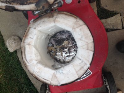

So I've had my first "meltdown" and notice I did not update my build with hinged lid upgrade, so here is some pics two birds one stone. I developed a hole in my steel crucible from repeated use ( old steel pipe from a clothesline post and an angle iron expansion with 1/4 steel plate welded to the bottom. Was my second design and has survived over 90LBS of aluminum being processed) I had to tip over the foundry (it's welded to the mower) to drain, I pivoted on the front wheels an poured it into my "Hershey bar". I'm glad I didn't put a drain hole as I was able to recognize the issue and deal with it in a timely manor without finding a molten puddle under the cart as my first sign of trouble, causing me to panic and or make some ill conceived attempt at containment. In the end, the aluminium foil formed as I made the pour pealed off the side wall and the remaining debris is of little consequence to further operation and is once again ready to use.
I kept the founder running after I removed the crucible and poured its contents in order to maintain a molten state as I prepared the recovery.

I've never burnt through one like that before! Looking at your pic it appears that the nozzle could be on more of a angle to help the flame wrap around the crucible (just a thought) I haven't even touched mine this year, but the garage has the ceiling back up and there is 2 more sheets of osb for the walls and electrical box to do unfortunatly that leaves mudding ( did i say I hate mudding ) and the new lights.
It was just a pin hole but I smashed it with a hammer looking for it, I'm likely just regularly running to hot a temp, the steel flakes off (?) the crucible walls. the pictures are deceiving, the torch is located to put the flame to the side and under the crucible with the 3/4" thick bolts under it, it is not directed at the spot with the hole. And for repeatability /Venturi effect I do put the crucible in the same orientation every time because of the spout.
Iron will dissolve in hot aluminum, I burnt through my first crucible by trying to speed things up on a first melt and had my burner cranked (30psi). One spot on the crucible was at yellow heat before the aluminum melted. I think that was where the hole developed. I patched with an overlay weld and have used the crucible with no problem. I now keep my burner pressure around 5 psi.
