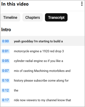

Well, you can always show transcript & probably download it too. But that can be just as time consuming, especially wordy folks. That is why I often paste video link directly into Gemini & say 'summarize this in 20 points' or ask specific questions. But, and this is a personal thing, learning software is a very visual. You see menu picking, drag & drop, mouse cursor manipulation, keyboard commands, screen interactions... all occurring in mere seconds. That does not readily lend itself to textbook type communication. I could say a 'large pointy rock' or, show you a picture of Ansel Adams mountain photo, different experience

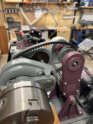

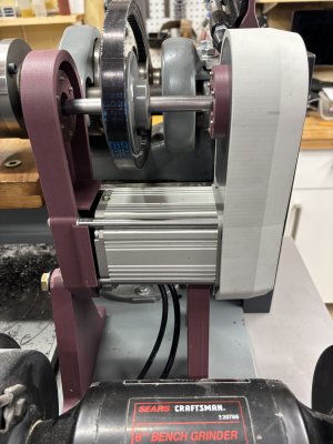

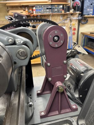

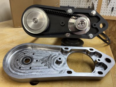

Had great success with PETG-CF. Used it to simulate a CNC machined steel motor mount. Proofed fit and function with the FDM part and then sent out for machining (I don’t own a CNC machine).
For general stuff, PLA is fine. White, black and gray are always in stock. 99% of my stuff is functional, not decorative.IMG_0834.jpeg
For general stuff, PLA is fine. White, black and gray are always in stock. 99% of my stuff is functional, not decorative.View attachment 81447
Second image is completed BLDC drive for my SB9.
