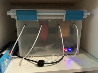

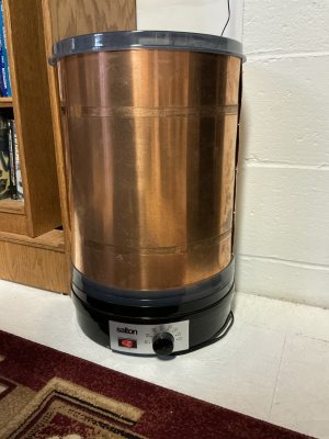

Humidity in the Great Lakes area is an issue in the summer. Not so much during the heating season. I still find that PLA needs some drying especially after hanging clothes to dry in the house, even in the winter.
I have built a modified food dehydration machine to hold a few spools at the same time.

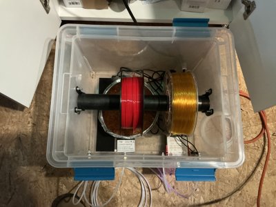

After that I needed a storage box which there are multiple builds in Printables etc.
I used a reptile heater and silicone gel beads. This works very well and similar to having a Golden Rod in a gun safe.

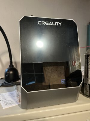

I also bought on a sale a Creality dryer.
I want to rearrange my print station to better integrate the storage boxes with my printer.

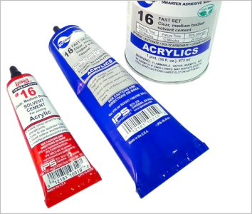

PLA can be bonded permanently with a variety of adhesives. I think this was discussed quite a bit elsewhere. I bought a dedicated plastic adhesive Weld-On 16. These adhesives etch (soften) plastics which is a different mechanism to normal bonding. Having said this I have an arsenal of glues & PLA lends itself to all kinds of CA glues, regular, plastic-formulated, black-rubberized. They will all hold beyod where the PLA will fail.
