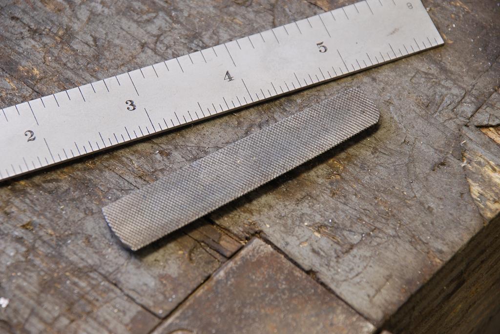

if just burrs, use a burr file. Scrapers tool. A short section of a file that has been stoned down so only bits that project between the teeth get cut, it just skates over everything else
