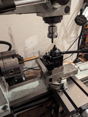

In the lathe configuration, I replaced the stock tool post with a wedge style quick change with carbide insert tooling (Acusize). I still have the steady and follow rests, but never use them - the bed is just too short. I mostly use the tailstock for drilling, but i did supplement the stock dead centers with a live one just in case

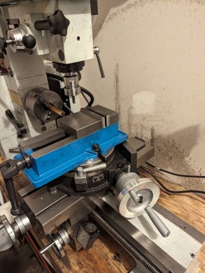

In the mill configuration, I added a much better vise and a rotary table - the combined height brings the work close to the quill. It has limited extension and unlike a knee mill, there is no other way to bring the work up. I also added an ER32 MT3 collet set and carbide tooling (Acusize again) which is much more accurate and capable. I had to make a custom draw bar, an bunch of custom T nuts, and to rebuild the manual feed on the quill, but I have it to a point that it can do +/- 5 thou.
But at least half the time is spent calibrating because absolutely every change needs to take all the tools off, and putting something new onto the bed. Then dialing that in before the next cut etc.

Thanks for all that! I have several friends with combo machines but they are not forum friendly. I'll be showing them your setup.
I confess I was blown away when I saw your vise - let alone that it was on a rotary table no less!
I really like the flexibility that a T-slot bed lends to a lathe. I wish they all had that but especially mine. I don't have enough meat in my cross-slide to add that.
