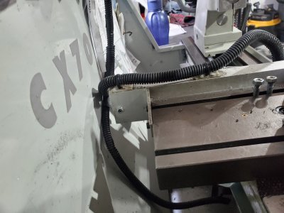

@Larry_C9 you would need to add an extension like @Xyphota did here in post 10 so that you have coverage for the full travel. @TorontoBuilder 's machine barely uncovers the head so only a short extension is needed.
D :cool:
Larry I just clued in to what I think you meant.....here's the backside of the crosslide. I made a small extension to hold the scale and it just nicely clears the backsplash when fully extended.

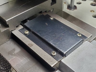

Yes , but mainly when it is all the way forward. Did your lathe come with the metal cover over the cross slide screw cavity ? Mine is exposed when the cross slide is back like that.
Oh yes that metal cover was standard issue with the lathe. Here's a close up of it.
What lathe do you have?
