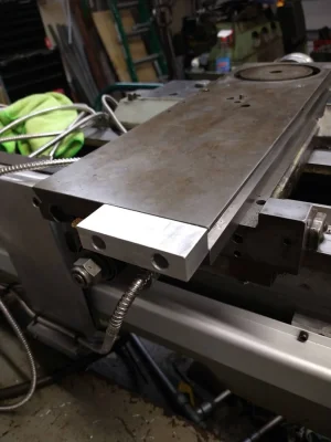

I used the Magna slim scale from DRO Pros and mounted it on the tail stock side. It made it a little more difficult for getting at the gibbs screws and cross slide lock but not impossible. I haven't run into any problems getting my tail stock close enough to the chuck and the mount for the read head acts like a stop to prevent the tail stock from slamming into the scale. They didn't recommend putting the scale on the chuck side in case some thing were to drop on it and on my lathe the mount for the follow rest is on there. I have used the follow rest a few times when cutting threads in small diameter parts. They said a guard on the Magna slim was not necessary but I put one on anyway just to help keep it cleaner and it is so slim there was room. Picture attached

Here's the top view.
Now that I look at it and think about it, there's no reason I couldn't drill and tap the left side flats for the follow rest.

It's a no brainer guys. Don't put it on the chuck side or on the tailstock side.....
Put it INSIDE the cross-slide. Safe from harm, doesn't interfere with ANYTHING!
@Xyphota did one a while back
@TorontoBuilder just did one
And I am in process.
You don't need room for the whole scale - just the scale strip (think piece of thick tape). You only need 50 thou or so. Easy peasy to mill a shallow slot to hold the scale. And the scale can be held in place with double sided tape.
It really is a no brainer guys. Also, looking at the Yuri website, the touch dro is compatible with magnetic tape.
If I were a lathe manufacturer, the slot would already be there! And truth be told, mine was just a few thou short of already being there!

@YotaBota and others following the thread, I'm not sure if you've seen some of the other discussion about scales so I'll repeat a bit here in case. When I was looking at scales (@Susquatch as well) I found that once I engaged Ditron (chat window in their ads on the AliEx site) and told them what I thought I wanted for scales they offered up some trade-offs and one was to give me all 1u scales for the price of 5u so keep that ready to bring up. I had intended to go 1u for the cross and 5u for the carriage but since they offered 1u at no additional cost......
They (and others) offered me different size scales, the smaller the profile the bigger the price. I settled on magnetic with a slim head, one a mountable scale, one just tape, slim glass for another and regular glass for the other 3. That gave me the best fit/price trade-off for each location. If budget is a consideration there are choices.
