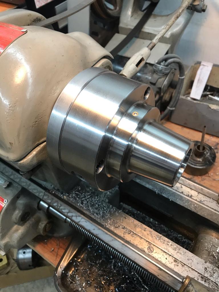

My 5C collet chuck arrived today.
It’s the same one the Clough42 did a video on. He got decent results.
Took a few minutes to machine the backplate flat and round. Things was like a taco chip, .02 runout on the face, same amount out of round on the register. Thankfully there was enough material to true up the register.
Managed to get it to .00025 runout before I shut the lights off and came inside.
Always interested in the procedure used to cleanup registers and surfaces — it doesn’t come naturally to me, even when I see diagrams posted.
Where did that come from? I never see anything new offered with a 1-1/2" - 8 TPI back plate.
I first spun it on the spindle to see how concentric and flat it was. Turned out it wasn't. Nor did it thread on very far because the spigot was almost 3/4" deep.
I chucked in my 4-jaw, spigot facing out. dialed it in off the spigot. I then turned off about 1/2", basically all of the non threaded portion. Then I bored out 1/2 deep so that it would screw all they way to the spindle register. A bit of a chamfer and done.
I unscrewed the 4-jaw so I could try the fit on the spindle. Fit like a glove.
I loosened the 4-jaw and took it off.
Took a facing cut on the area the chuck rests on to get that flat and then gradually eased up to the register dimension with very light cuts and checking the chuck for fit with every pass.
It was a perfect fit on my second pass.
