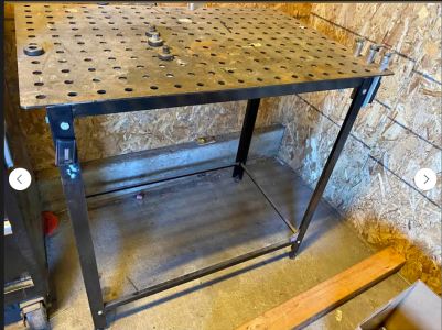

nice score, thats $300 at PA not on sale without any hold down clamps, buttons etc. I picked mine up a few years ago for ~$160 on sale and its good enough for what I do, plus if tried making it myself I'd still be drilling holes...
Oh is it from PA?
I couldn’t find a label.
I have to decide what to do with it as I already have a 24” x 36” x 1/2” table that I built. No holes though.
