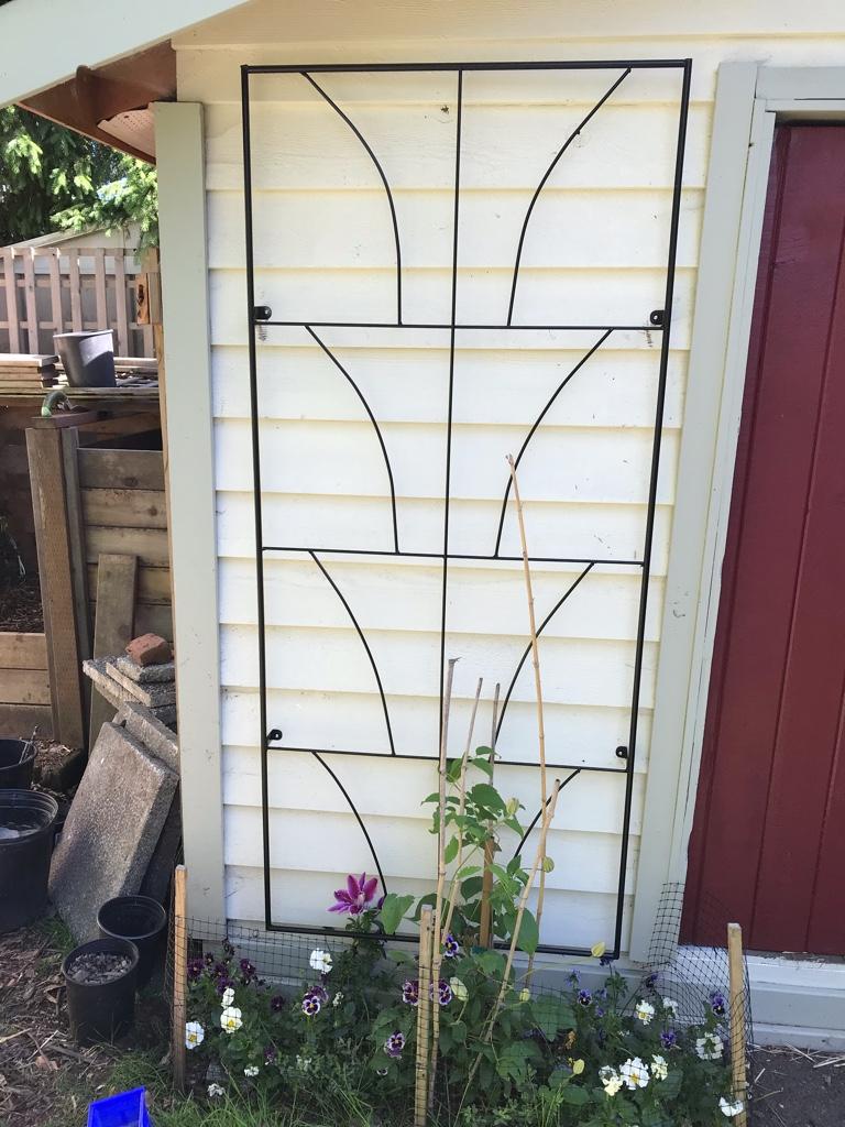

Whipped up a trellis for the clematis on our shed. There will be another on the opposite side plus a connecting piece over the top.

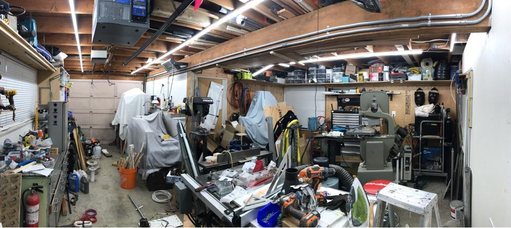

I know this is an old photo, but I really enjoy looking at pictures (or visiting) other shops.
Sometimes I feel like we should have a chaos and best organized competition. I like them all.
I can't help but think I would be a bit prouder of a neater shop, but then I realize mine would never be like that. It's just not my nature. At my age, I'm not about to change very easily and the mental stress of trying to be someone I'm not would prolly kill me.
FWIW, @David_R8 , I think that photo of your shop is neat compared to mine. But I also have tractors, farm equipment, and a boat in mine.
Any chance you have a recent photo of the same area that you care to share?
@YYCHM , @David_R8
Hah, yeah I'll shoot one from the same vantage point today. Different stuff, same mess :P
Here you go.
As I said, different stuff; the surface grinder is gone from the corner. In it's place is the CNC router.
Now that I have a bit of CNC design/build under my belt I may embark on a rebuild of my CNC plasma cutter.
We shall see...
