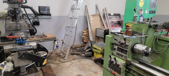

Spent some time this weekend rearranging my machine shop area in the shop. The big Stanley Vidmar cabinets were in the way of the attic opening and ladder. The 24"x8' workbench was under the 19" deep cabinets and wasn't very usable anymore. The cabinets could only go in at the height they are due to my window heights. Window bottoms are 8' from the floor. The wall cabinets are 36" tall, and the bottom edge is 60.01" off the floor. Thankfully the Vidmars are 59.99" tall. Here's some pics.
old pic but it shows the layout a bit better.

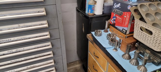

Moved the bench and mill. There is probably 1000 lbs of stock in that cabinet. It all had to come out first. I stuck the beer fridge in the corner. This would prove to be a mistake.
Moving the Vidmar cabinets was no easy task. They weight about 1000lbs each empty. So all the drawers and slides had to come out. Most drawers were too heavy so I had to empty them. Shop looked like a bomb went off.
Cabinets moved, reloading the drawers in.
My beer is now trapped forever. Going to have to rethink this.

The beer fridge will be getting moved, probably today. Until i slid the second cabinet in place it looked like access would be tight, but acceptable. Hydration is extremely important, especially after the work is done, so I can't leave it like this.

Blocking in the beer fridge sounds like a Homer move, "DOH". lol

I don't know what I was thinking with the beer fridge. Definite brain fart there.
