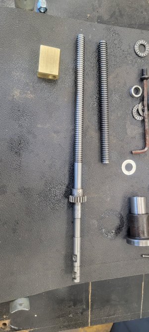

Got er drilled and tapped for 9/16 8tpi LH Acme. Looks like I nailed the height pretty good. The old nut was super worn, so I had to measure the machine and do math stuff.
As you can see, it's a bit longer. I'm going to split it partway and add an adjustment screw for the future owner. The fit on the unworn threads is excellent, so the cheap Chinese tap I used did better than expected.
I was a bit leary of using a cheap tap, but it actually worked very well. Used plenty of oil and reversed the lathe every few turns. No issues.
I wanted to tap the nut first so i can control the fit when i make the screw. 9/16-8 Acme, especially LH, is such an oddball thread. Most charts don't list it. Screws and nuts aren't available.
More progress today. Seemed more appropriate to use my SM1660 , to fix the SM1120, instead of the Emco. Also threading is sooo much nicer on the 1660.
Took quite a few passes since I didn't heave room for the follow rest. It worked out great after several spring passes.
Re-reamed the original shaft at .374", rather than .3125, turned a .375 x 1" long spigot on the end of the new screw and pressed them together with Loctite sleeve retainer for lube. It was a tight fit and required some heat to seat fully.
The interface:
Somebody someday might wonder how they threaded tis shaft back then:
All assembled. The fit between the nut and threads is way better than I expected. Zero play but threads on very smooth. Final fitting was done with 600 grit and scotchbrite.

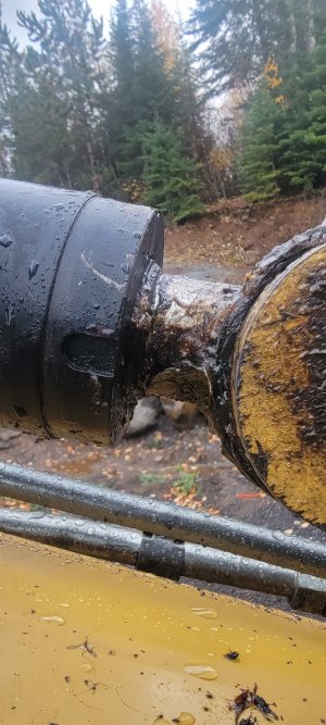

I have to rebuild the boom cylinders on my excavator. I tried loosening the gland nuts with a normal hook spanner, but they wouldn't budge. So I made this wrench.
That's the gland nut with its 4 notches.

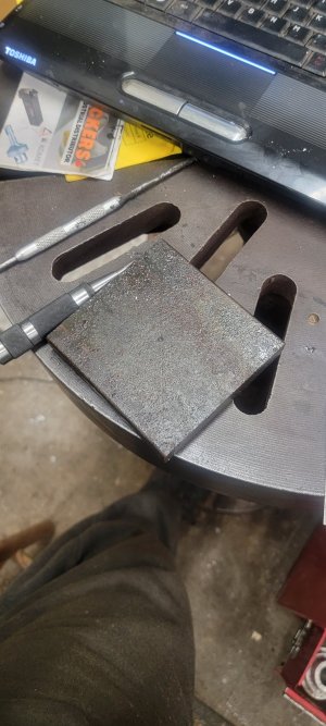

Started with a 4.5x4.5x0.75" plate
Bored a 3.2"ish hole on the lathe, then gripped it on the bore and knocked the corners off.

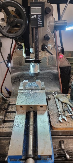

I notched it for the cylinder shaft and drilled and tapped the 4 corners for 3/8 bolts to engage the notches.
Test fit was good.
